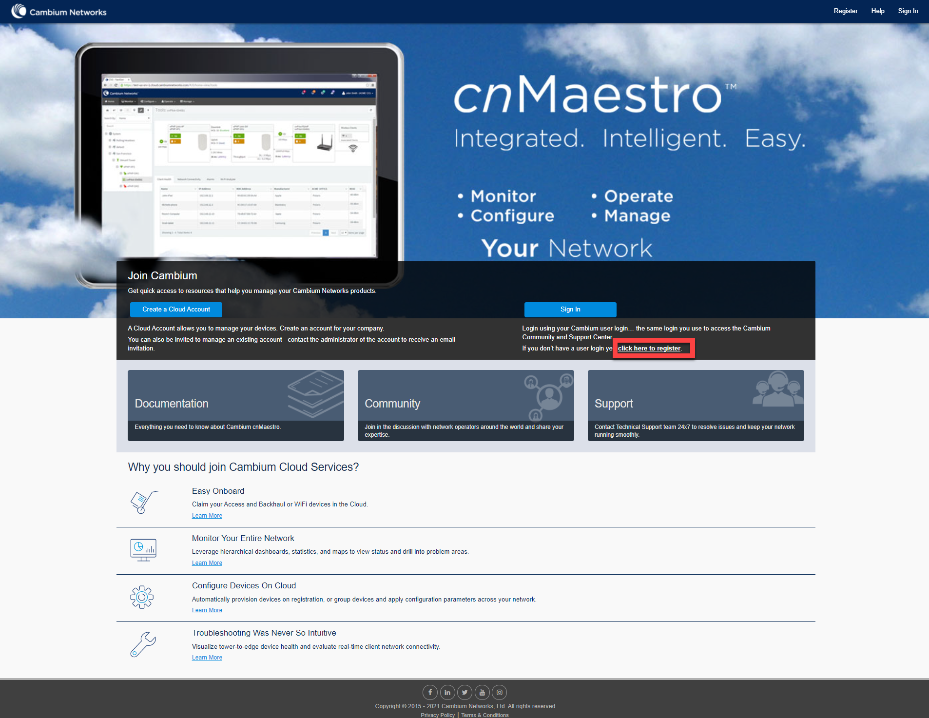

1. Open a web browser and enter https://cloud.cambiumnetworks.com into the address bar.
The cnMaestro Main login page appears, as shown in Figure 1.

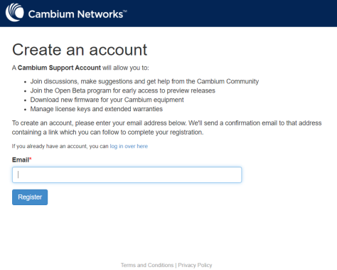

2. Select the click here to register link under Sign In.
Figure 1  The main login page
A registration form appears, as shown in Figure 2.
Figure 2  Initial registration form
3. Enter your email address and click the Register button.

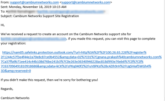

An email from Cambium Support Center is sent with a link for validation.
4. Check email and click the validation link, as shown in Figure 3.
Figure 3  Email from Cambium Support to validate account
Note:
If you do not receive the email, check your spam folder.

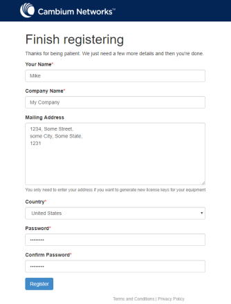

The Finish registering form appears, as shown in Figure 4.
Figure 4  Finish registering form
5. In the registration form, you must enter details such as your name, company name, country name, and password.
6. Click Register to complete the process.

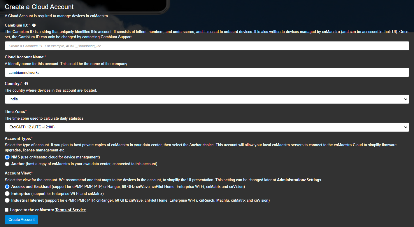

3. Select Create a Cloud Account.
The Create a Cloud Account page appears, as shown in Figure 5.
Figure 5  Create a Cloud Account form
4. Enter the required details and complete the form.
Note:
The Cambium ID is the primary identifier of the account. It may optionally be used to onboard devices.
5. Click Create Account to complete the process.

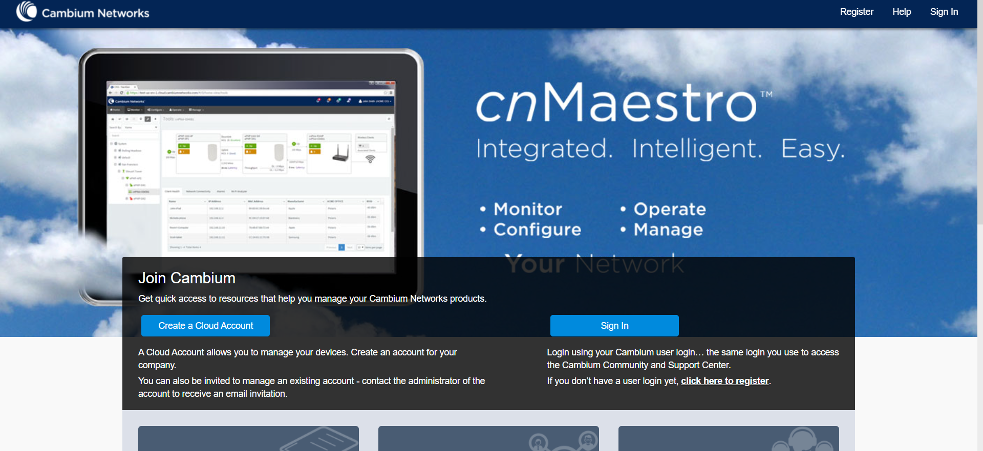

The cnMaestro Main login page appears, as shown in Figure 6.
Figure 6  Main login page

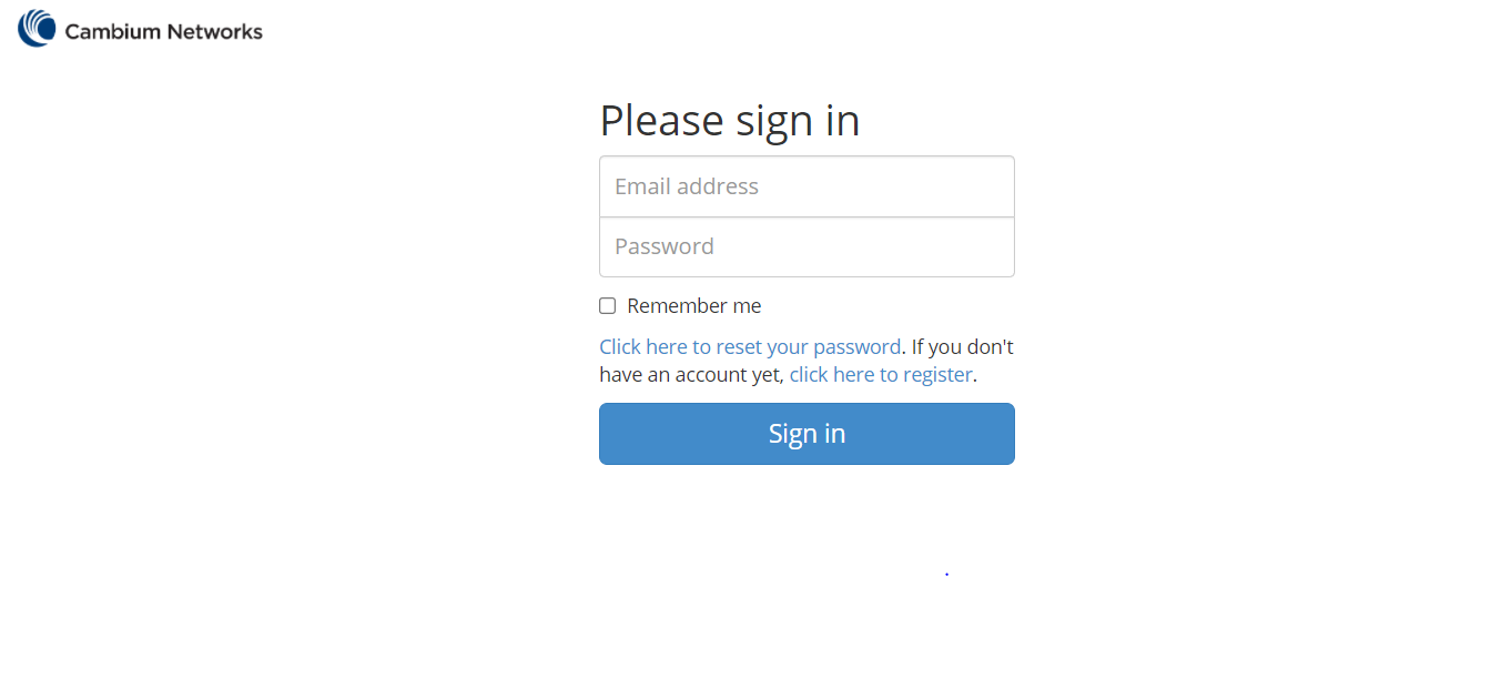

2. Click Sign In.
Please sign in page appears as shown in Figure 7.
Figure 7  Sign in page
3. Enter your email address and password.
4. Click Sign in.

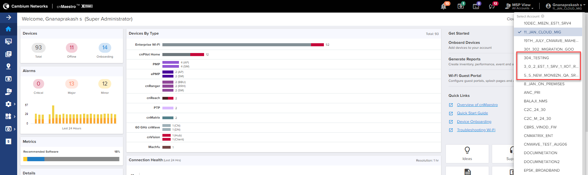

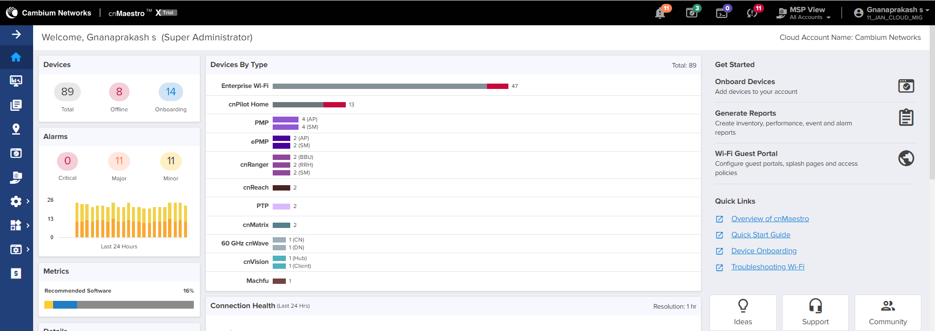

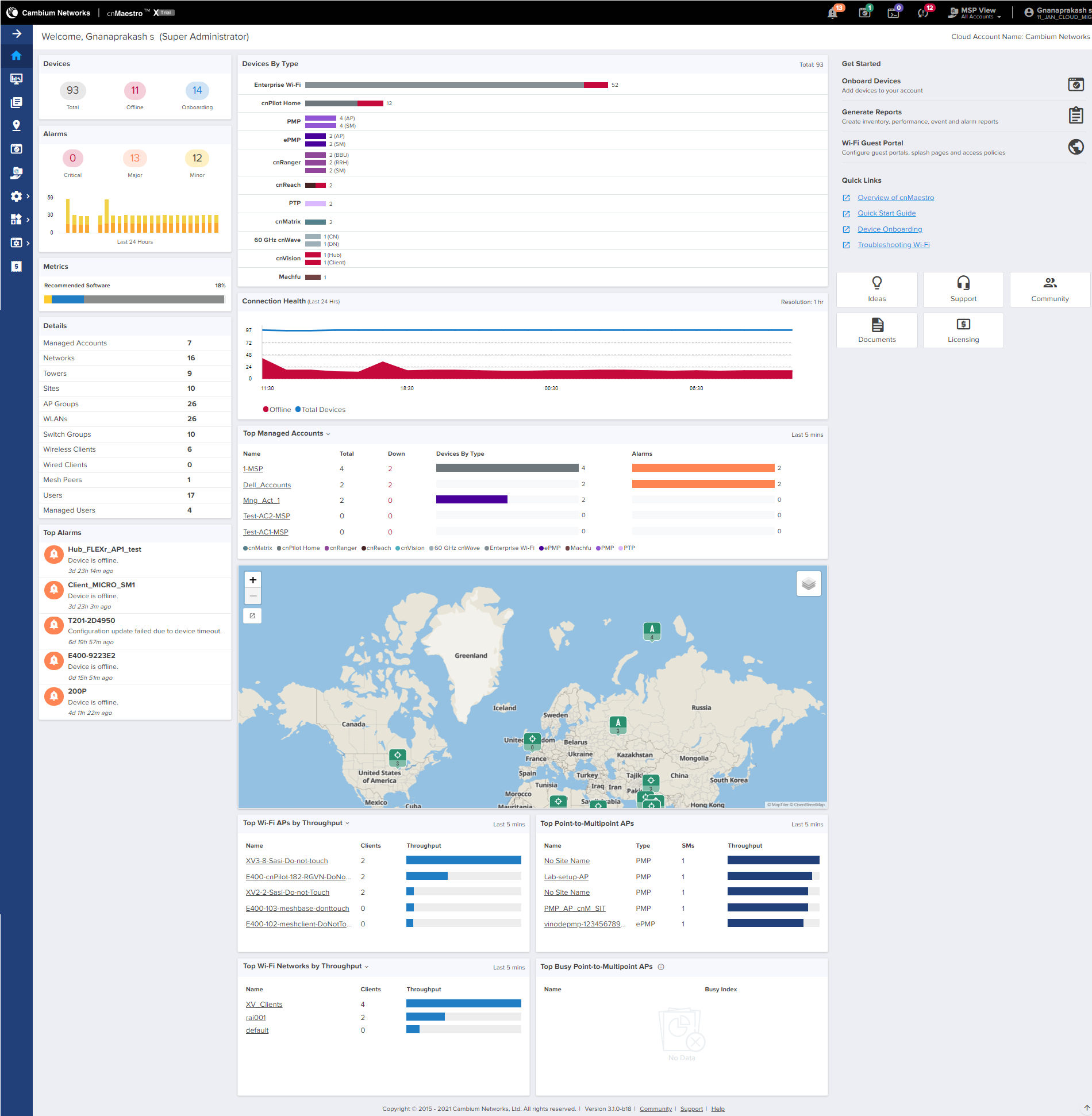

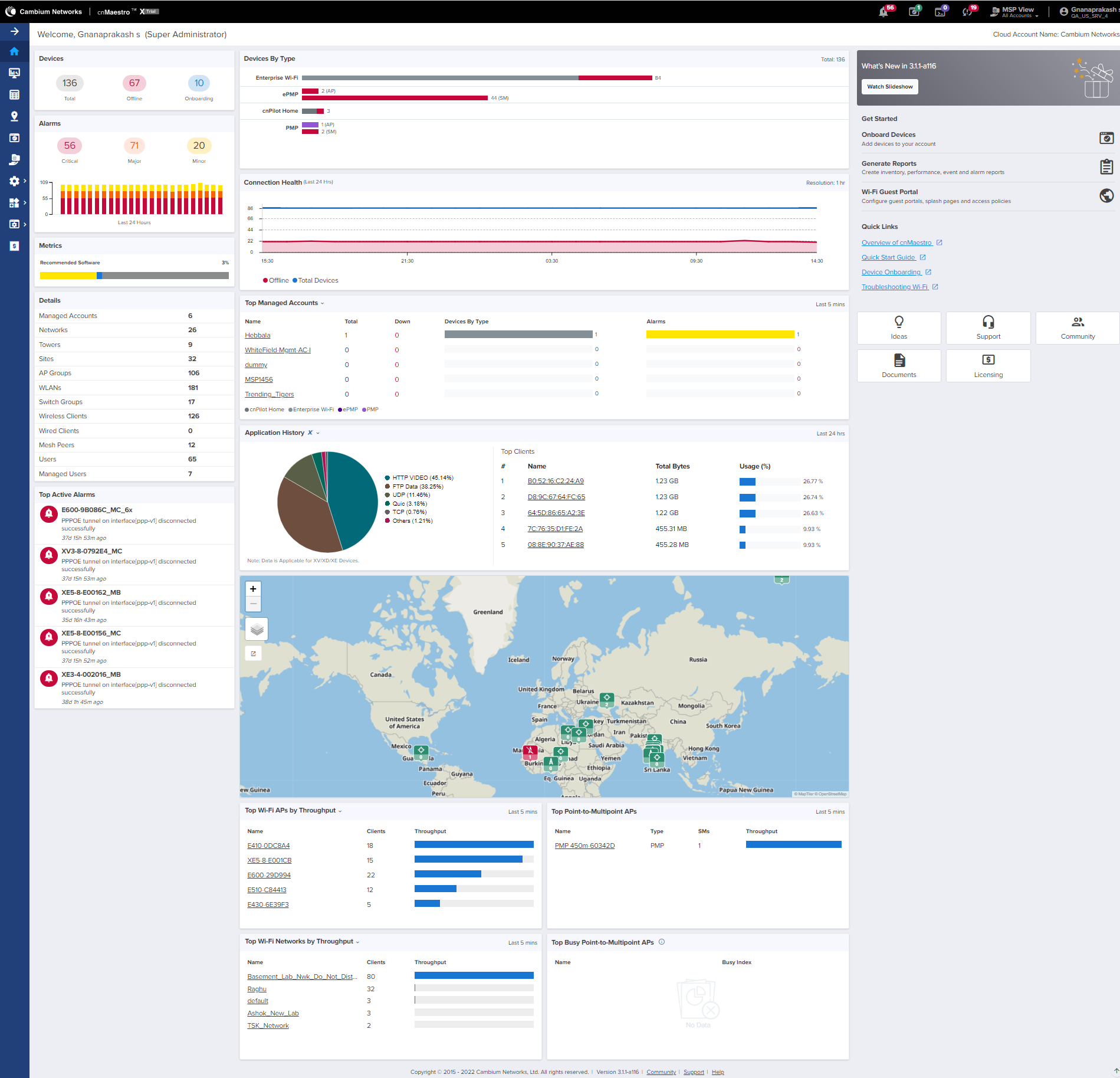

The cnMaestro Home page appears, as shown in Figure 8.
Figure 8  cnMaestro Home page

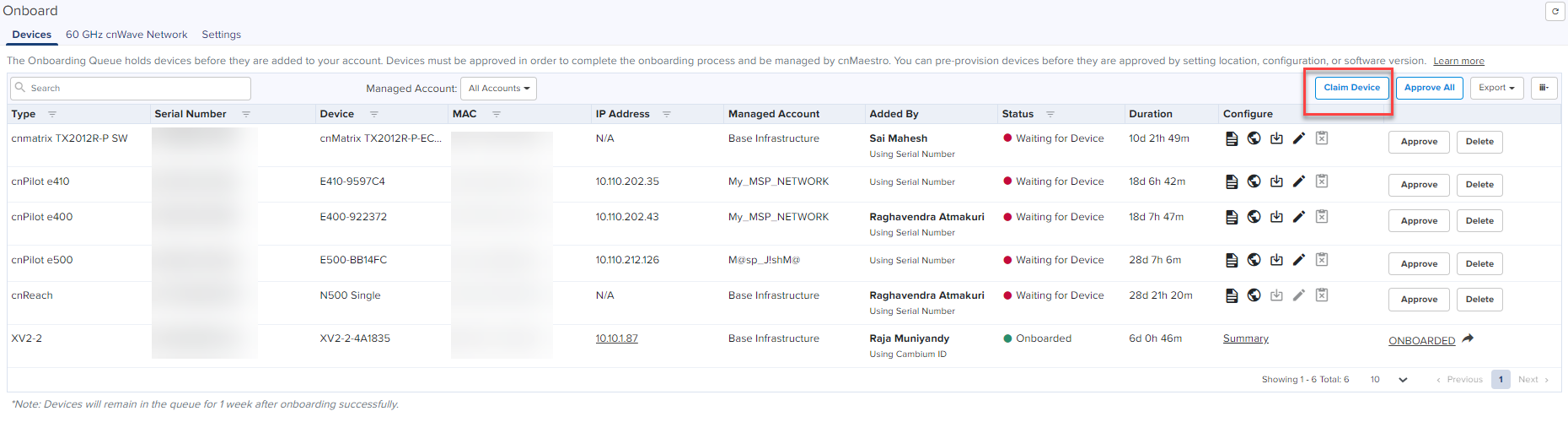

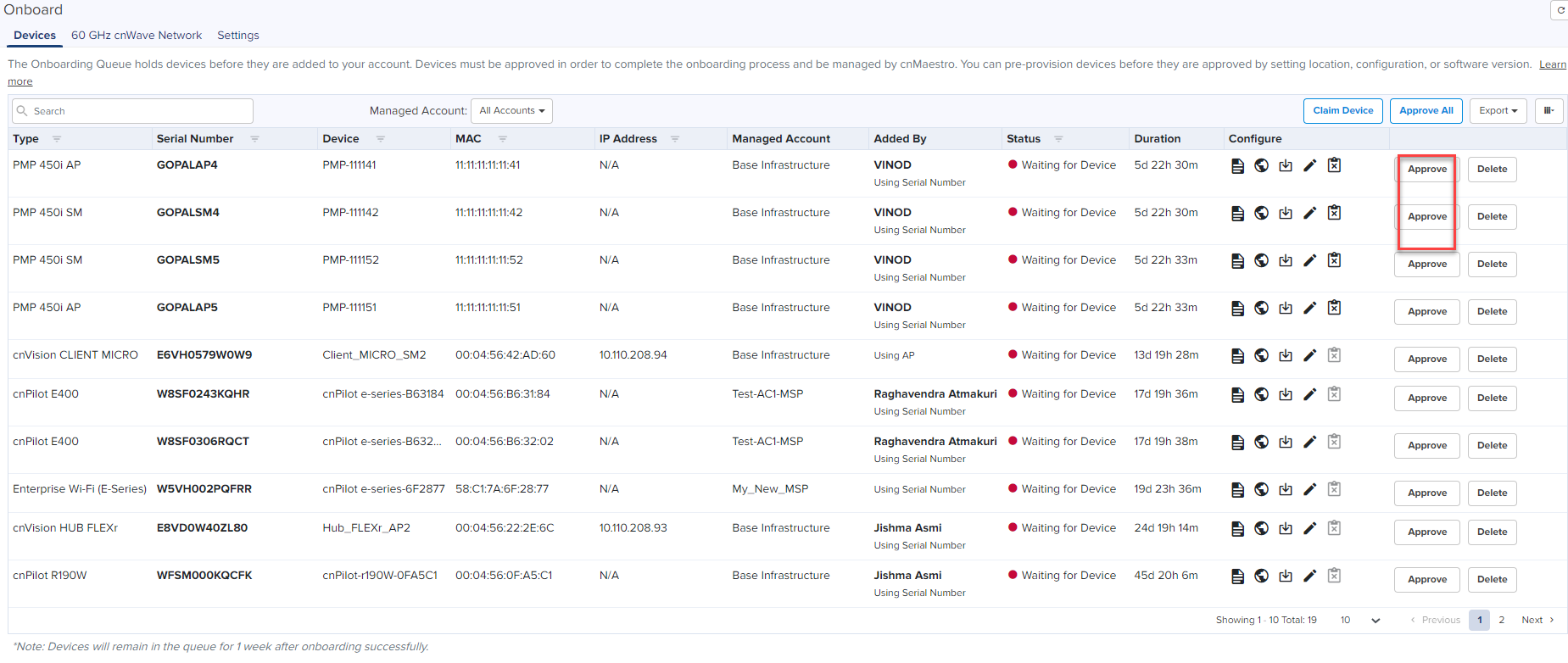

1. From the Home page of cnMaestro, navigate to Onboard > Device tab.
The Onboard page appears with details of the devices and their serial numbers, as shown in Figure 9.
Figure 9  Onboard page

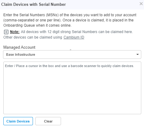

2. Click Claim Devices located at the right side of the Onboard page (as shown in Figure 9).
The Claim Devices with Serial Number page appears, as shown in Figure 10.
3. Enter the serial number of the device in the text box located under the Managed Account drop-down, as shown in Figure 10.
Note
You can also place a cursor in the text box and use a barcode scanner to quickly claim the devices.
Figure 10  Claim Devices with Serial Number page
4. Click Claim Devices.

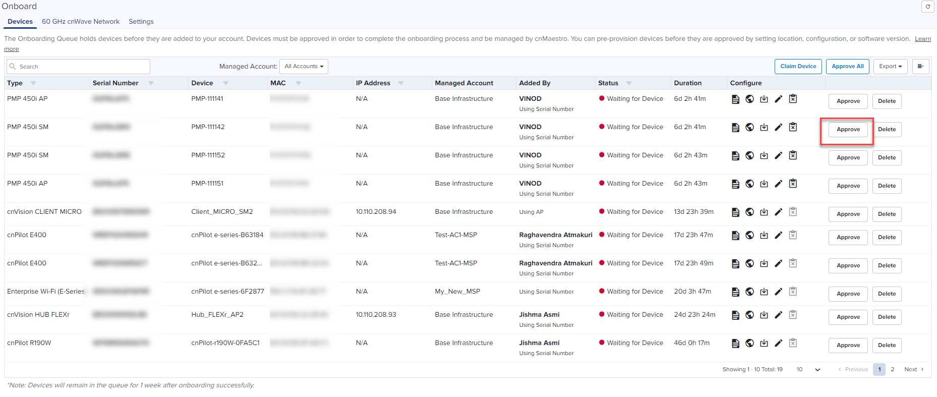

5. To onboard the device when it contacts cnMaestro, click Approve at the right side of the Onboard page, as shown in Figure 11.
Figure 11  Onboarding Queue
Note
If you do not click the Approve button, the device remains in the Onboarding Queue.

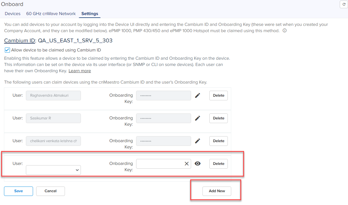

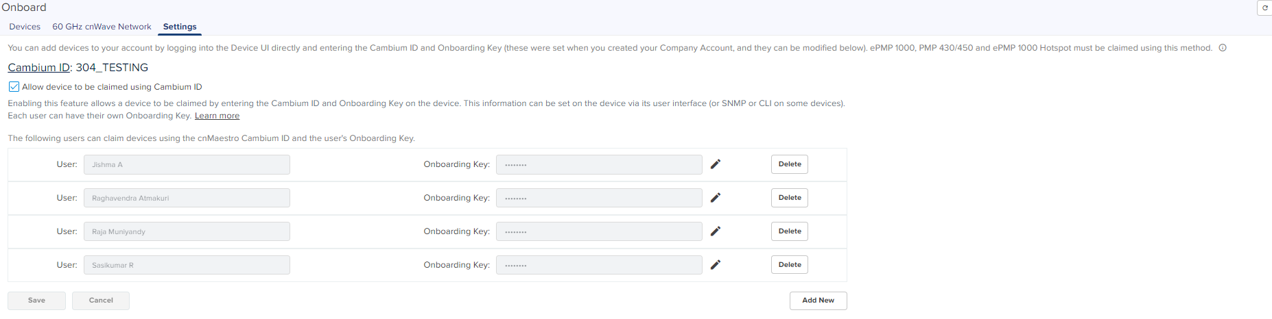

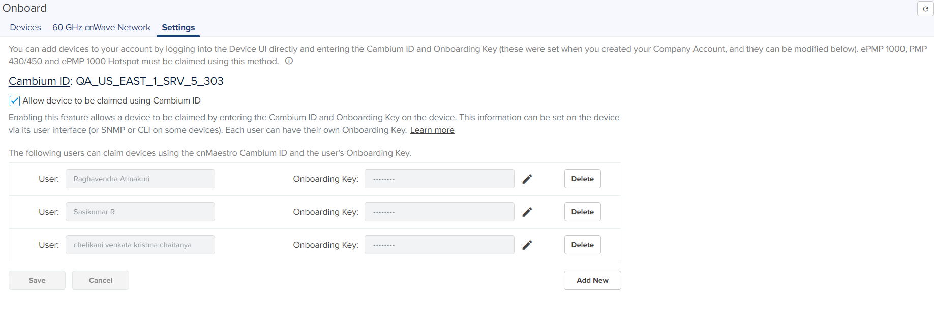

2. From the Home page, navigate to the Onboard > Settings tab.
Figure 15  Onboard settings page
3. Select the Allow device to be claimed using Cambium ID check box.
Enabling this feature allows one to add Onboarding Keys mapped to individual Users.
4. Click Add New to add a User and Onboarding Key.
A new row appears as shown in Figure 16.
Figure 16  New claim devices
5. Select the User from the drop-down.
6. Enter the Onboarding Key.
7. Click Save.

Once in the Onboarding Queue, the devices can be provisioned and managed by clicking the Approve button, as shown in Figure 17.
Figure 17  Device approval

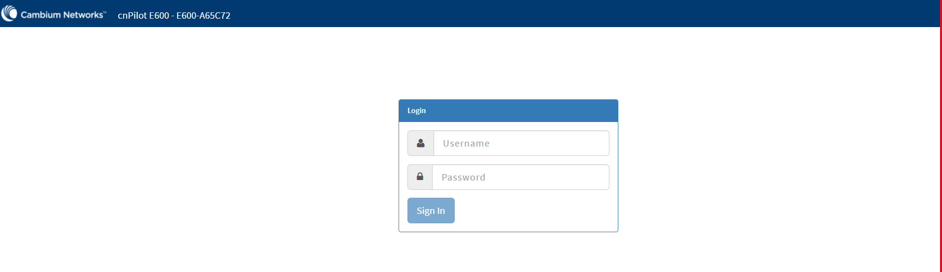

1. Log on to the Device UI.
The Sign In page appears, as shown in Figure 18.
Figure 18  Login page
2. Enter your Username and Password.
3. Click Sign In.

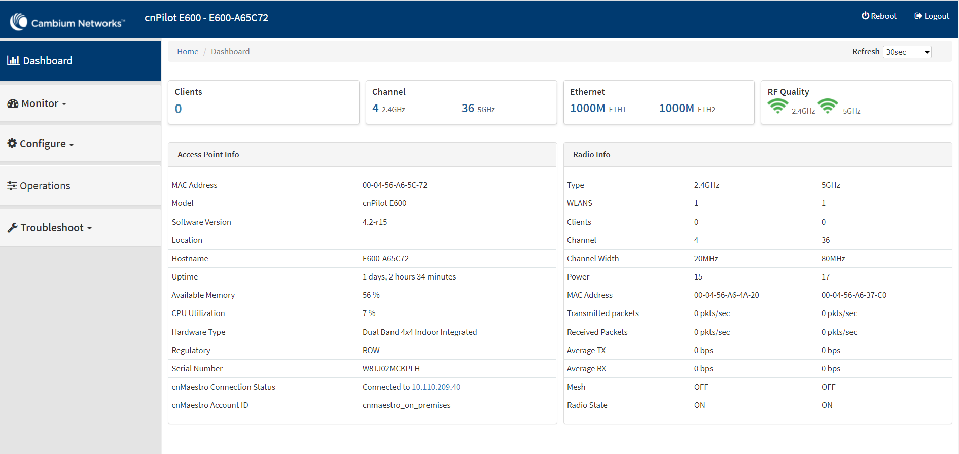

The device home page appears, as shown in Figure 19.
Figure 19  Device home page

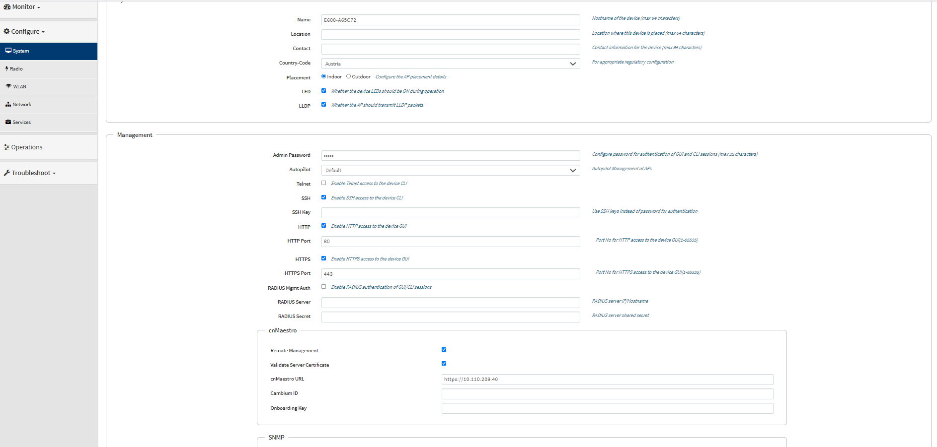

4. From the Home page, navigate to Configure > System > Management.
System configuration page appears, as shown in Figure 20.
Figure 20  cnMaestro configuration
5. Enter URL in cnMaestro URL to connect the server (by default it will be cloud.cambiumnetworks.com), as shown in Figure 20.
6. Enter the Cambium ID.
7. Enter the Onboarding Key.
