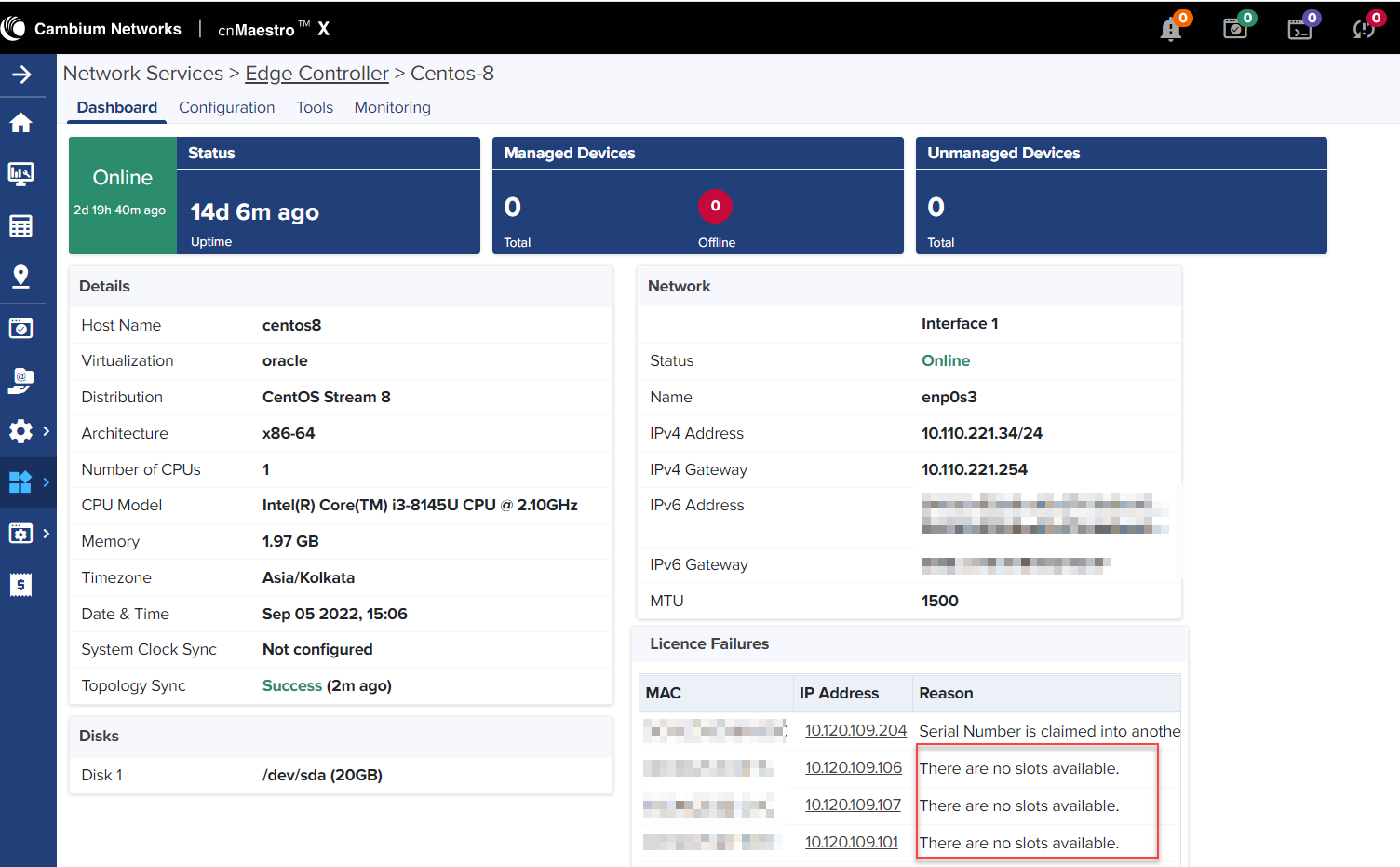

l Not Enough Slots available in PTP 820/850 devices
User receive the license failure message in PTP 820/850 device dashboard, when no slots are available.

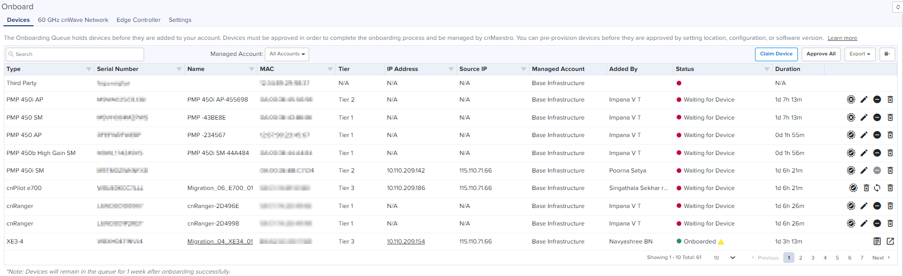

The following table details the columns in the Onboarding Queue. Some of these fields will be unknown or uncertain until the physical device has contacted Cloud Management.
Table 2: Onboarding fields
Parameter
Description
Actions
Before a device is onboarded, it must be approved. There are two buttons available:
l Approve: Click Approve to enable the device for onboarding. If the device is connected, it will be onboarded immediately.
l Delete: If the device has been added in error, you can delete it from the Onboarding Queue. This also disconnects the device and allows it to be added to another account. The Delete button is only enabled before the device has started the onboarding process.
Added By
The user who added this device for onboarding.
Note: If the Device is claimed by a tenant user, the user information is not shown on the Onboarding page.
Configure
This highlights configuration that is applied to the device before onboarding. It is presented as a set of icons that represent: software update, configuration update, and map placement. The icons have the following colors:
l Gray: Indicates that nothing is applied.
l Green: Indicates that the parameter is set and applied when onboarded.
Device
The name of the device. This is set manually, or, if unset, it will be read from the device.
Duration
Displays when the status last changed for the device.
IP Address
The IP address of the device. This is only available after the device contacts cnMaestro.
MAC Address
The MAC address of the device (if known).
Serial No
The Serial Number of the device.
Status
The current status of onboarding:
Waiting for Approval: The device has contacted cnMaestro, but it has not been approved, so it is in a waiting state.
Waiting for Devices: The user has claimed the device, but the device has not connected.
Onboarded: The device has completed onboarding and must now be managed through normal Configuration and Software Update processes.
Type
The type of the device (if known or manually configured).

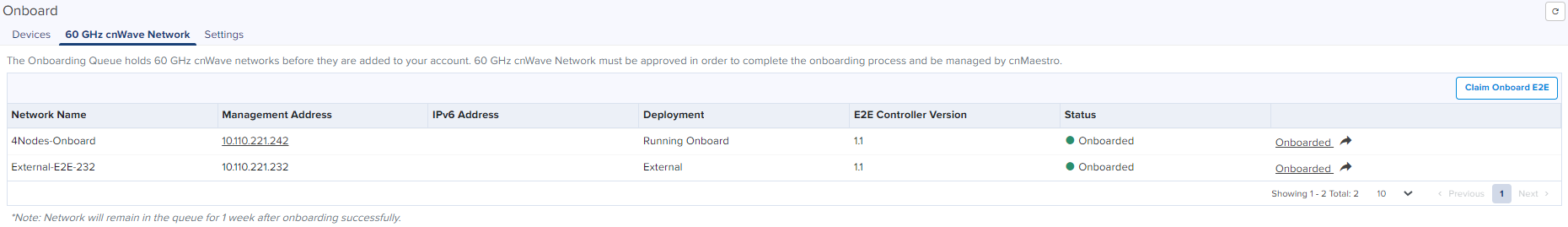

60 GHz E2E Controller Onboarding
The Onboarding Queue has a separate tab for 60 GHz cnWave E2E Controllers, which must be approved by the user before they are added to cnMaestro as an E2E Network and can manage 60 GHz cnWave devices. This approval can be done either through the Onboarding Queue or the Hierarchical Tree (where the E2E Network is placed).
Once the onboarding is approved, the 60 GHz cnWave E2E Network (and its devices) can be managed by cnMaestro.
NOTE:
If Auto Generate IPv6 Addresses is enabled, E2E Controller fetches the IPv6 addresses automatically.
Refer to 60 GHz E2E Controller Onboarding chapter for details on how to onboard E2E devices.

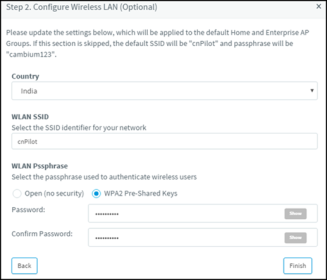

3. Enter basic default configuration, such as Country Code, WLAN SSID, and WLAN Passphrase.
By default,
Country Code is the same as that defined during start-up
WLAN SSID will be cnPilot for both the radios (2.4 and 5 GHz)
WLAN Passphrase is cambium123 with WPA2-PSK as the security mode
4. Click Finish.

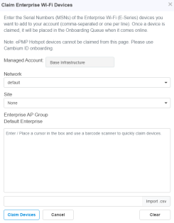

Claiming Wi-Fi devices from AP Group
To claim multiple devices from the AP Group, navigate to the Wi-Fi AP Groups tree view and click the
drop-down menu for the selected AP Group.
1. Click the Claim Devices option.
2. In the pop-up dialog select the Network and Site under which these devices should be placed and by default devices claimed under this group will have its configuration settings.
3. Specify the Manufacturing Serial Numbers (MSNs) of the devices line-by-line or comma-separated, or click the Import .csv option to import the MSNs of the devices from a file.
4. Click Claim Devices to add to the selected AP Group with the configuration applied.

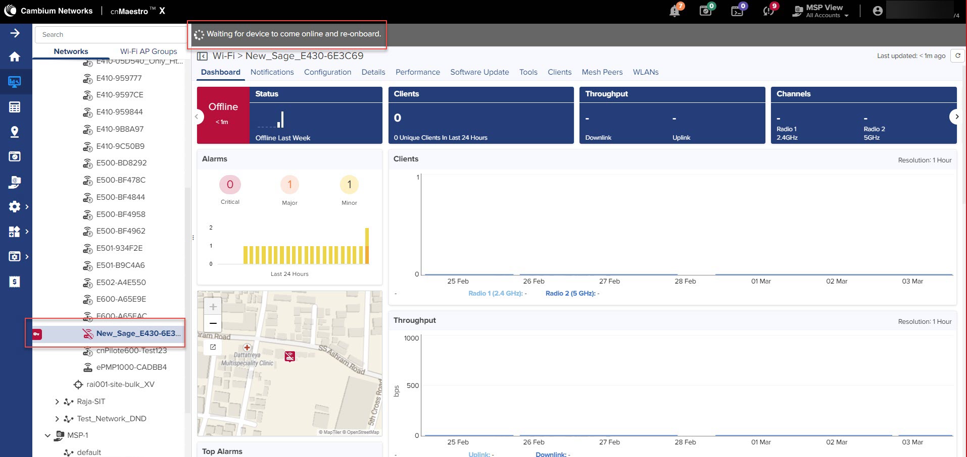

When Onboarding completes, the device will no longer be managed through the Onboarding Queue. Instead, Configuration and Software Upgrade needs to be performed through the standard cnMaestro UI sections.

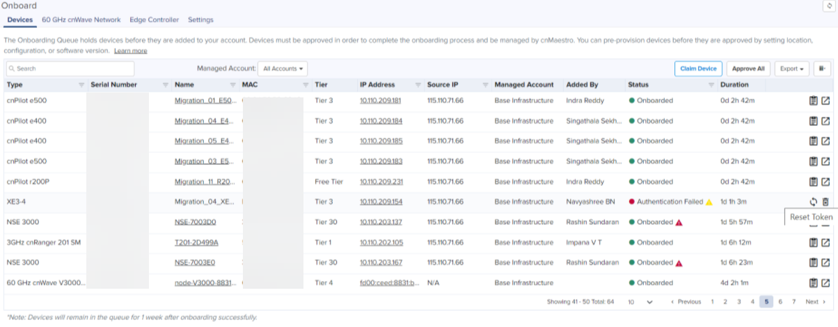

Reset Authentication Token from cnMaestro
When a device first connects to cnMaestro, it is provided a token (cookie) that is used in further connections. A device might lose or change its token when it undergoes the following procedures:
When the device is Onboarded to multiple instances of Cloud or On-Premises.
When the device is Factory Reset.
When a user manually deletes the token.

You must enable the reset token by clicking on Reset Token in the Onboarding Queue page or in the Main menu.
Figure 8  Reset Token: Main menu
The router issues a new token for the device, then the device changes to Approve or Delete state in the Onboarding Queue page.
Figure 9  Onboarding Queue: Reset token
Click Approve on the Onboarding Queue page.
Figure 10  Onboarding Queue: Status
When the token is reset, the device is onboarded to cnMaestro.
Figure 11  Reset Token Approve
