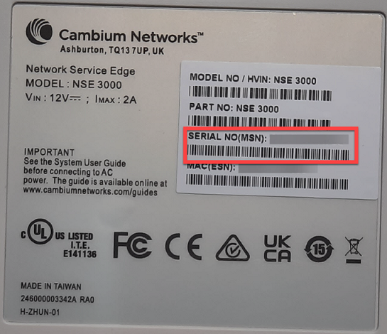

A device manufacturer serial number (MSN) is required to claim an NSE device. You can find the device MSN at the bottom of the device as shown in Figure 1.
Figure 1  MSN of the NSE device

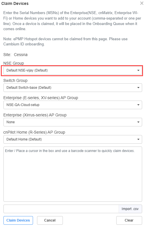

3. Click theactions icon and select Claim Device(s).
The Claim Devices window appears, as shown in Figure 3.
Figure 3  The Claim Devices window
4. From the NSE Group drop-down list, select the required group.
NOTE:
The selected NSE group is automatically pushed to the device while onboarding.
5. In the Enter field, enter the MSN of the NSE device.
6. Click Claim Devices.
The NSE device that is associated with a site is claimed successfully.

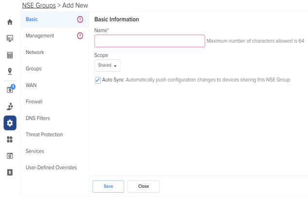

To configure parameters on the Basic Information page, complete the following steps:
1. Navigate to Configuration > NSE Groups and click Add.
The Basic Information page appears, as shown in Figure 5.
Figure 5  The Basic Information page
2. Configure the parameters, as described in Table 1.
Table 1: Parameters on the Basic Information page
Parameter
Description
Name
Name for the NSE group.
This parameter allows a maximum of 64 characters.
This is a mandatory parameter.
Scope
Scope determines the availability of the NSE group across different tenant accounts.
By default, the following options are supported:
  • Shared - Configured NSE group will be available to other tenant accounts.
  • Basic Infrastructure - Configured NSE group will be available only to the Basic Infrastructure user. Other tenant accounts will not have access to the NSE group.
Auto Sync
Specifies whether the configuration changes made to the NSE group are automatically applied to all devices associated with the group.
By default, auto sync is enabled.
3. Click Save.

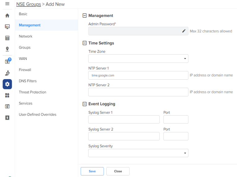

Management
Using the Management tab, you can configure the profile-related parameters such as time settings and event logging.
To configure parameters on the Management page, complete the following steps:
1. On the NSE Groups > Add New page, select the Management tab.
The Management page appears, as shown in Figure 6.
Figure 6  The Management page
2. Configure the parameters, as described in Table 2.
Table 2: Parameters on the Management page
Parameter
Description
On the Management page, there are Management, Time Settings, and Event Logging sections.
Management
Admin Password
The password used to authenticate the NSE 3000 users who access through SSH or web.
This parameter allows a maximum of 32 characters.
Note: Click the editicon to reset the password.
Time Settings
Time Zone
The time zone based on the installation location of the device.
Select an appropriate time zone from the drop-down list to ensure that the device clock is synchronized with the wall clock time.
NTP Server 1
The IPv4 address or domain name of the primary Network Time Protocol (NTP) server.
NTP Server 2
The IPv4 address or domain name of the secondary or a backup NTP server.
Event Logging
Syslog Server 1
The IPv4 address or the domain name of the syslog server 1.
Port
The port number of the syslog server 1 to which the syslog messages are sent.
Supported values: 1 to 65535.
Syslog Server 2
The IPv4 address or the domain name of the syslog server 2.
Port
The port number of the syslog server 2 to which the syslog messages are sent.
Syslog Severity
The logs with the selected severity level that must be forwarded to the server.
The following options are supported:
  • Emergency (Level 0)
  • Alert (Level 1)
  • Critical (Level 2)
  • Error (Level 3)
  • Warning (Level 4)
  • Notice (Level 5)
  • Info (Level 6)
  • Debug (Level 7)
3. Click Save.

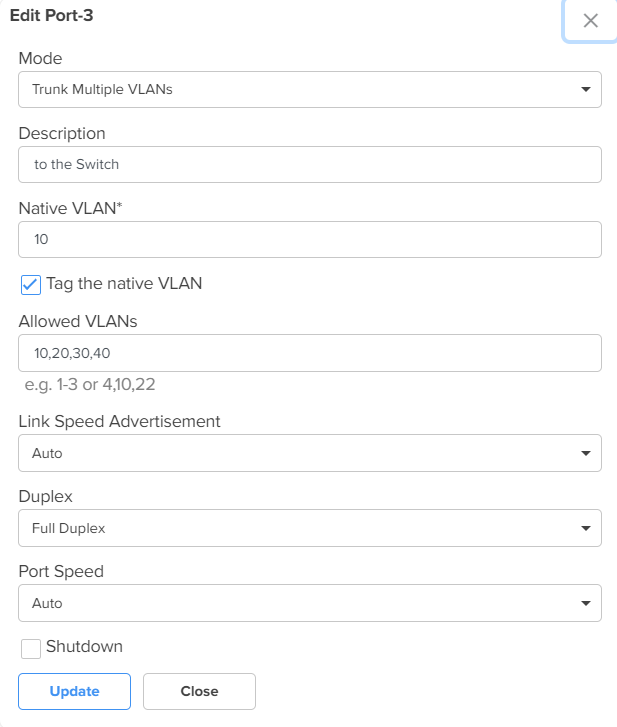

LAN Ports
Click the edit icon to modify the configuration of the corresponding LAN port as shown in Figure 8, and click Update to apply the changes.
Name
Name of the LAN port.
This parameter cannot be modified.
Mode
The VLAN mode of the port.
  • Access Single VLAN: An access port which places all traffic on its configured VLAN and only passes untagged traffic.
  • Trunk Multiple VLANs: A trunk port which allows the selected port to accept or pass 802.1Q tagged traffic.
Description
A brief description of the LAN port.
VLAN
This parameter is applicable only when the Mode parameter is set to Access Single VLAN.
By default, VLAN value is 1.
VLAN value can be in the range: 1 to 4094
Native VLAN
Indicates that the traffic on the native VLAN is untagged. This parameter is applicable only when the Mode parameter is set to Trunk Multiple VLANs.
The Native VLAN value can be in the range: 1 to 4094
Tag the native VLAN
This parameter is applicable only when the Mode parameter is set to Trunk Multiple VLANs. When Tag the native VLAN parameter is enabled, the native VLAN traffic is tagged with 802.1Q.
Allowed VLANs
This parameter supports a range or comma-separated list of VLANs. Example: 1-3 or 4, 10, 22
Link Speed Advertisement
Indicates the port speed that must be configured for advertisement.
Default: Auto
  • Auto
  • 10 Mbps
  • 100 Mbps
  • 1000 Mbps
Port Duplex
Specifies the mode of port communication. The following options are supported:
  • Full Duplex
  • Half Duplex
Port Speed
Specifies the port speed.
Default: Auto
  • Auto
  • 10 Mbps
  • 100 Mbps
  • 1000 Mbps
Shutdown
Enables or disables the port.
By default, this parameter is disabled.

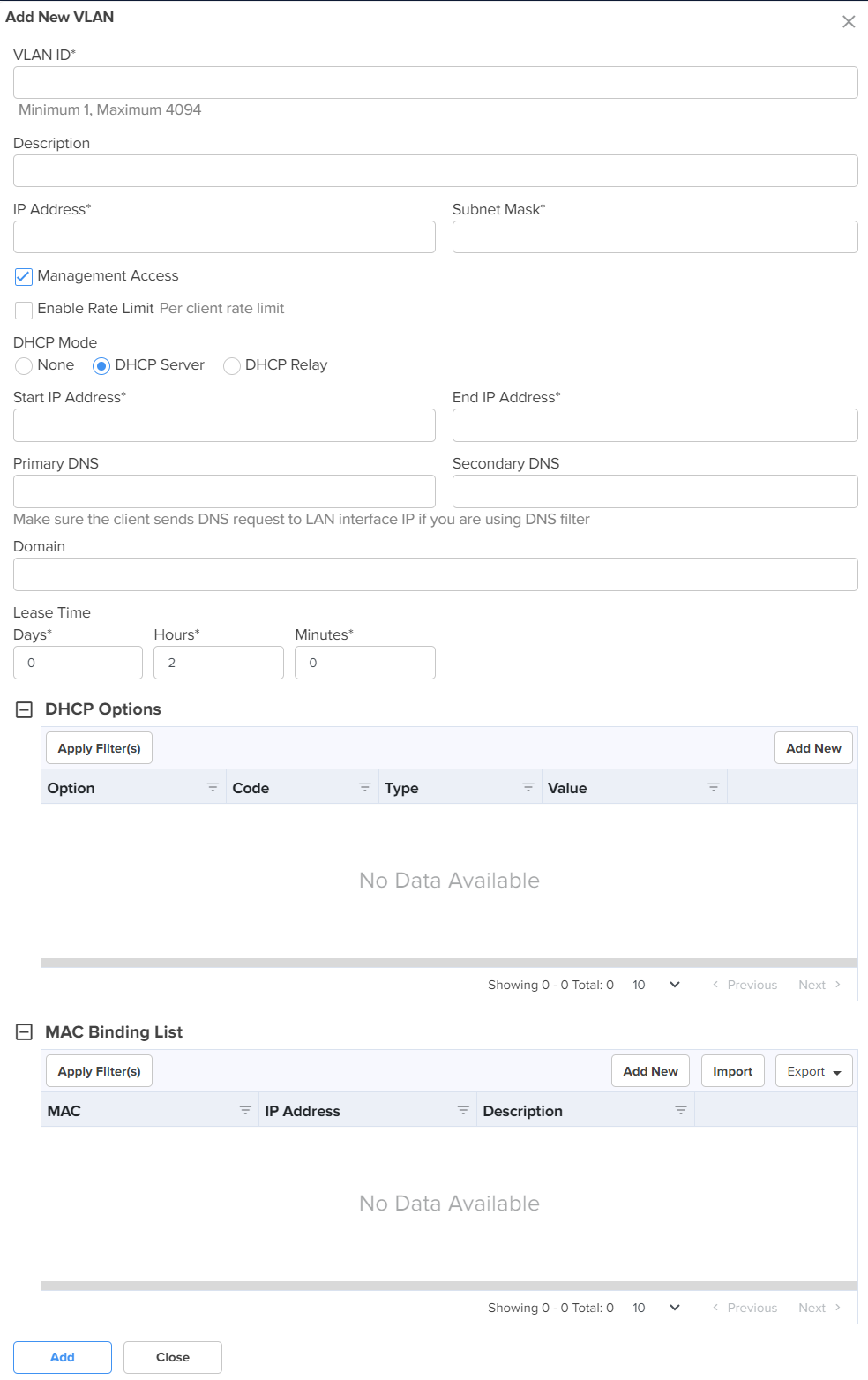

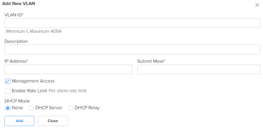

VLANs
Note: You can configure up to 16 VLANs.
To add a new VLAN, click Add New. The Add New VLAN window appears, as shown in Figure 9.
To edit an existing VLAN configuration, click the edit icon and modify the parameters in the Edit VLAN window. Finally, click Update to apply the changes.
VLAN ID
Indicates the VLAN ID.
The VLAN ID value can be in the range: 1 to 4094
Description
Displays the user-configured description for the VLAN.
IP Address
IPv4 address that is assigned to the VLAN.
Subnet Mask
Subnet mask that is assigned to the VLAN.
Management Access
Indicates whether the management access is enabled or disabled.
By default, this parameter is enabled.
Enable Rate Limit
Indicates whether the rate limit is enabled or disabled.
When you select the Enable Rate Limit check box, the Rate Limit parameter appears.
Rate Limit
Specifies the rate of requests sent or received. This parameter appears only when you enable the Enable Rate Limit parameter.
This parameter supports only integer values.
DHCP mode
  • None
  • DHCP Server - When you select this option, the DHCP server-related parameters appear.
  • DHCP Relay - When you select this option, the Relay Server IP address parameter appears.
DHCP Server
In addition to the below parameters, you must also configure the parameters in the DHCP Options and MAC Binding List sections, as shown in Figure 10.
Start IP address
Starting IPv4 address in the range.
End IP address
Ending IPv4 address in the range.
Primary DNS
The primary DNS server for clients on the network.
If the DNS server option is enabled on the NSE, the IPv4 address configured for the VLAN can be provided as the DNS server for the network.
Secondary DNS
The secondary DNS server for clients on the network.
Domain
The DNS search domain for the network.
Lease Time
The DHCP lease expiry time for the DHCP pool (in Days, Hours, and Minutes).

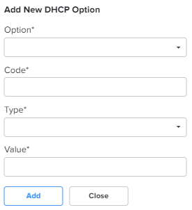

DHCP Options
NSE allows configuration of standard and custom DHCP options.
To add a new DHCP option, click Add New. The Add New DHCP Option window appears, as shown in Figure 11.
To edit an existing DHCP option, click the edit icon and modify the parameters in the Edit DHCP Option window. Finally, click Update to apply the changes.
Option
The following DHCP options are supported:
  • Log server(7)
  • Domain name(15)
  • NTP server(42)
  • Vendor specific information(43)
  • Vendor class identifier(60)
  • TFTP server name(66)
  • Boot file name(67)
  • Proxy auto config(252)
  • Custom
Code
A value for the code.
This parameter allows a maximum value of 254.
Type
  • Text
  • IP Address
  • Integer
Value
A value in ASCII.

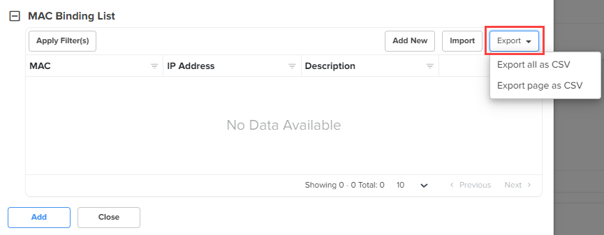

MAC Binding List
For every DHCP pool configured, the user can bind the client MAC address with an IPv4 address from the network. This enables the client to obtain the same IPv4 address whenever they connect to the NSE device.
Following parameters are required to create the binding list:
  • MAC address of the client
  • IPv4 address from the configured pool
When you set MAC and IP address fields and click Add, the binding of MAC and IP address is added.
Note: Upto 200 MAC to IP address bindings are supported per DHCP pool.
Note: When you bind, the binding IP address should be outside the DHCP pool range.
To add a new MAC binding, click Add New. The Add New MAC Binding window appears, as shown in Figure 12.
To edit an existing MAC binding, click the edit icon and modify the parameters in the Edit MAC Binding window. Finally, click Update to apply the changes.
MAC
The MAC address of the client.
IP Address
The IPv4 address that must be assigned to the client.
Description
Displays the user-configured description.
Import
Imports the MAC bindings.
Note: The CSV file that you import must be in the three-column format, for example, MAC, IP address, and Description.

Export
Exports the configured bindings list.
  • Export all as CSV
  • Export page as CSV
To export MAC bindings, click Export. The export options appear, as shown in Figure 14.
DHCP Relay
Indicates whether the DHCP relay unicasts the DHCP request to an external DHCP server.

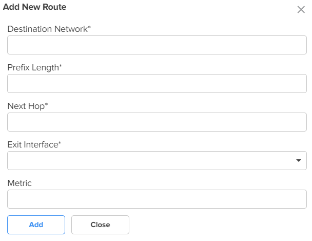

Static Routes
To add a new route, click Add New. The Add New Route window appears, as shown in Figure 15.
To edit an existing route, click the edit icon and modify the parameters in the Edit Route window. Finally, click Update to apply the changes.
Destination Network
The IPv4 address of the destination network.
Prefix Length
The prefix length for the network address.
This parameter supports integer values and a maximum value of 32.
Next Hop
The next hop IPv4 address for the route.
Exit Interface
The exit interface through which the next hop is reachable.
  • WAN-1
  • WAN-2
  • VLAN-1
  • VLAN-10
  • VLAN-20
  • VLAN-30
Metric
The metric for the route.
Figure 8  The Edit Port window
Figure 9  The Add New VLAN window
Figure 10  DHCP Options and MAC Binding List
Figure 11  The Add New DHCP Option window

Figure 14  The Export option in MAC Binding List
Figure 15  The Add New Route window

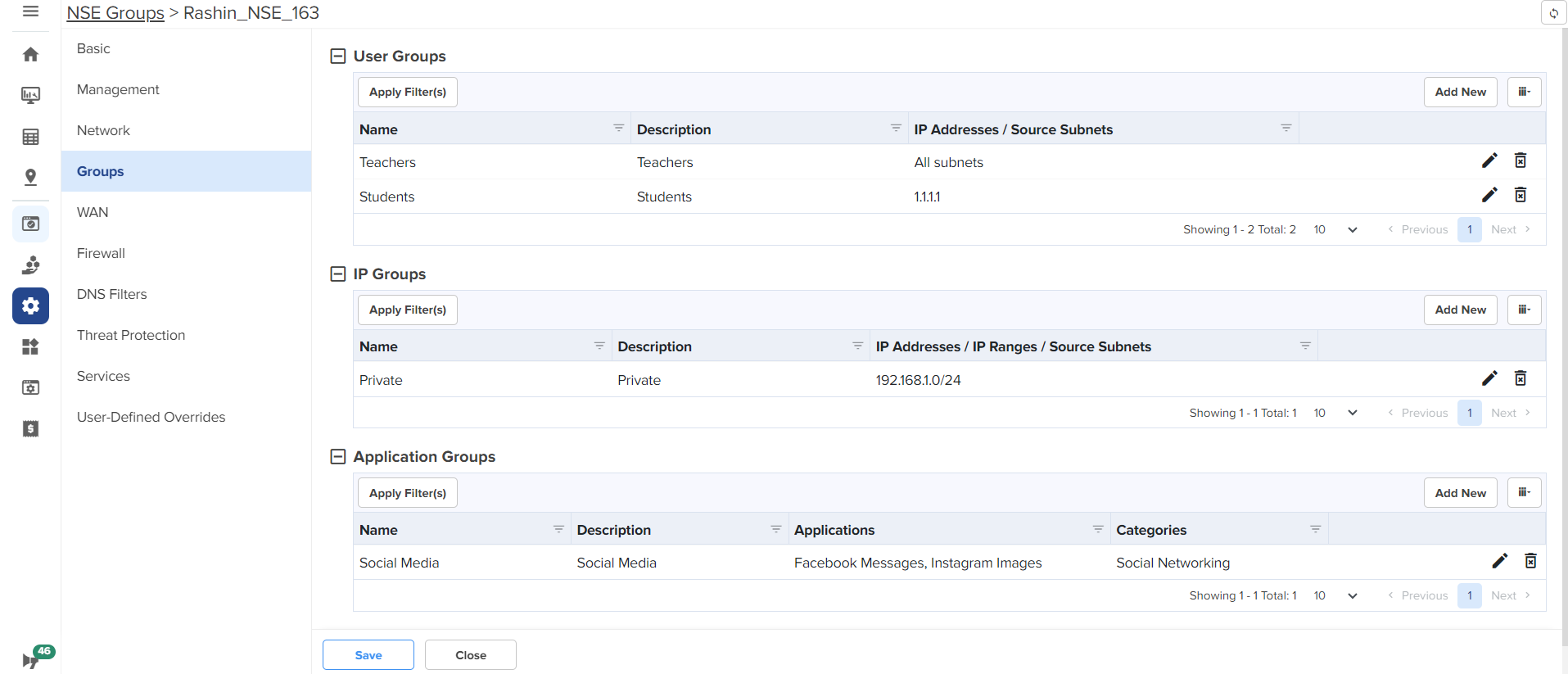

Groups
Using the Groups tab, you can configure user groups, IP groups, and application groups.
To view the Groups page, complete the following steps:
1. On the NSE Groups > Add New page, select the Groups tab.
The Groups page appears, as shown in Figure 16.
Figure 16  The Groups page
2. Configure the parameters, as described in Table 4.
Table 4: Parameters on the Groups page
Parameter Description
On the Groups page, there are User Groups, IP Groups, and Application Groups sections.

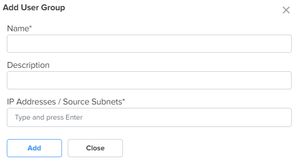

User Groups
User groups are used to group locally configured networks and these groups can be used to associate with policies, especially application rules or DNS rules.
To add a new user group, click Add New. The Add User Group window appears, as shown in Figure 17.
To edit a user group, click the edit icon and modify the parameters in the Edit User Group window. Finally, click Update to apply the changes.
Name
Name for the user group.
Description
Description for the user group.
IP Addresses/Source Subnets
IPv4 addresses or source subnets for the user group.

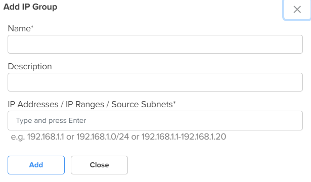

IP Groups
IP groups are used to group networks originating from the WAN, and can be used to attach port forwarding rules.
To add a new IP group, click Add New. The Add IP Group window appears, as shown in Figure 18.
To edit an IP group, click the edit icon and modify the parameters in the Edit IP Group window. Finally, click Update to apply the changes.
Name
Name for the IP group.
Description
Description for the IP group.
IP Addresses/IP Ranges/Source Subnets
IPv4 addresses, IP ranges, or source subnets for the IP group.

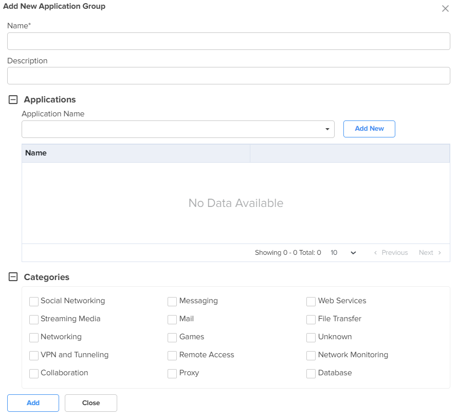

Application Groups
Application groups are used to group applications by using application names or categories, which can then be attached to a policy for permitting or denying access.
To add a new application group, click Add New. The Add New Application Group window appears, as shown in Figure 19.
To edit an application group, click the edit icon and modify the parameters in the Edit Application Group window. Finally, click Update to apply the changes.
Name
Name for the application group.
Description
Description for the application group.
Applications
To add applications to the application group, select the required application(s) from the drop-down list and click Add New. The selected applications are added in the Name list.
Application Name Applications for the new application group.
Categories
To include categories for the new application group, select the required categories.
Categories Categories for the new application group.
Figure 17  The Add User Group window
Figure 18  The Add IP Group window
Figure 19  The Add New Application Group window
3. Click Save.

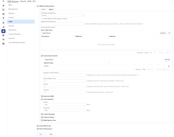

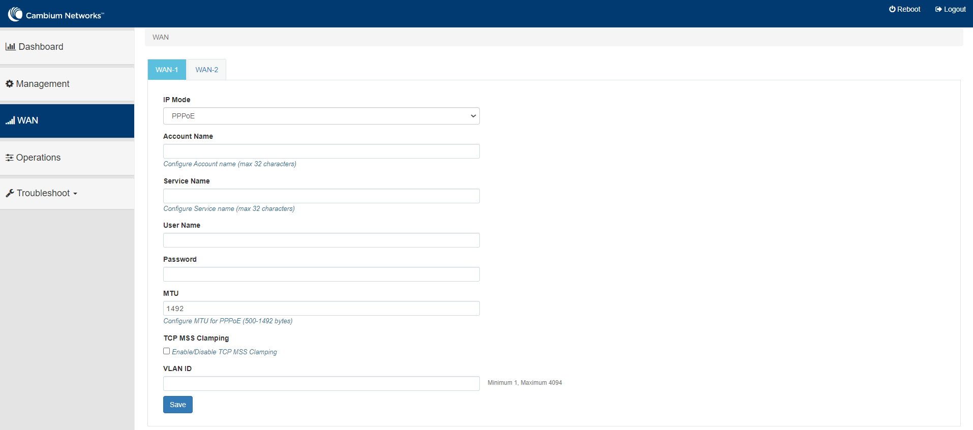

WAN
Using the WAN tab, you can configure the settings related to the WAN interface.
To configure parameters on the WAN page, complete the following steps:
1. On the NSE Groups > Add New page, select the WAN tab.
The WAN page appears, as shown in Figure 20.
Figure 20  The WAN page
2. Configure the parameters, as described in Table 5.
Table 5: Parameters on the WAN page
Parameter
Description
On the WAN page, there are WAN Configurations, Load Balancing, and Flow Preferences sections.
WAN Configurations
In this section, you can configure the parameters in Connection Health, Dynamic DNS, Link Capacity, Traffic Shaping, Failover Policy, and WAN Speed Test sections.
The same parameters appear in both WAN-1 and WAN-2 tabs.

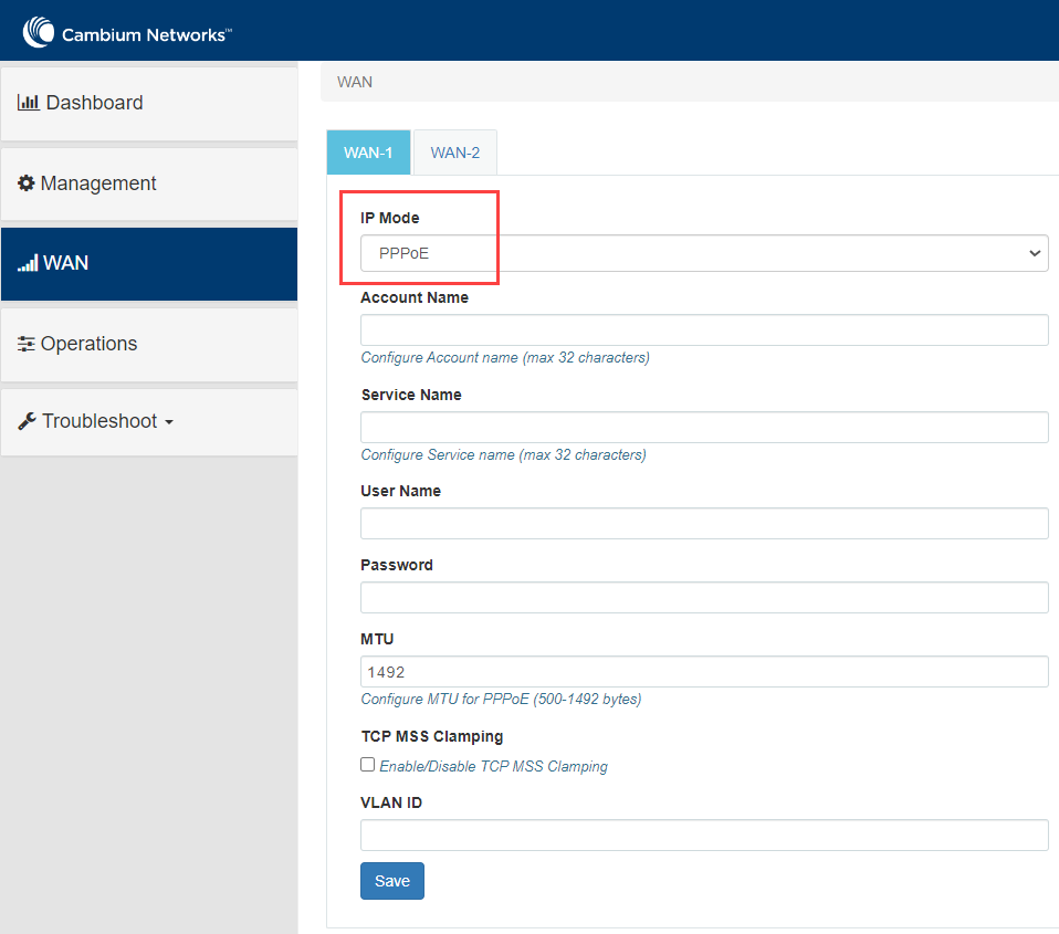

IP Address Assignment
Determines the mode of IP address assignment for the WAN interface.
  • Dynamic: Dynamically learn the IP address and DNS from the DHCP server.
  • Static: Manually configure the IP address, gateway, and DNS server IP provided by the service provider.
  • PPPoE: When you configure PPPoE, you must provide the username and password of the service provider. While the account name and service name are not mandatory configurations, they may be required if the service provider enforces it. By default, the MTU is set to 1492 and the TCP MSS clamping is enabled. If required, you can also tag the packet on the WAN link to send.
Enable 802.1q VLAN tagging of frames
When this parameter is enabled, 802.1Q tag is inserted with configured VLAN ID for all the packets going out of the WAN interface.
VLAN ID
This parameter is applicable only when Enable 802.1q VLAN tagging of frames check box is selected.
VLAN ID range: 1 and 4094.
When the 802.1Q header is configured, all transmitted frames are expected to include the 802.1Q header with the same VLAN ID.
Following parameters appear when you select Static from the IP Address Assignment drop-down list.
IP Address
The IPv4 address of the WAN interface.
Subnet Mask
The subnet mask for the IPv4 address of the WAN interface.
Default Gateway
The IPv4 address of the default gateway for the WAN interface.
Primary DNS
The IPv4 address of primary upstream DNS server on this interface.
Secondary DNS
The IPv4 address of secondary upstream DNS server on this interface.
Following parameters appear when you select PPPoE from the IP Address Assignment drop-down list.
Account Controller Name
Name of the account controller.
This parameter is optional.
Service Name
Indicates the service name of the Account Controller.
The service name configuration is optional.
User
User name for PPPoE authentication.
Password
Password for PPPoE authentication.
MTU
MTU for PPPoE interface.
MTU ranges from 500 to 1492 bytes.
Default: 1492 bytes.
TCP MSS Clamping
Indicates whether TCP MSS Clamping is enabled or disabled.

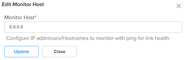

Connection Health
This section is configured to monitor the WAN connection health.
Click the editicon to modify the Monitor Host configuration, as shown in Figure 22. Finally, click Update to apply the changes.
To add a new monitor host, click Add New. The Add New Monitor Host window appears, as shown in Figure 23.
Monitor Host
The hosts used to monitor and collect network traffic data.
Default: 8.8.8.8
Number of Host Failures
The number of monitor hosts that fail to declare the link down.
Default value: 1
The maximum number of monitor hosts that can be configured to fail is 5.
Failure Detect Time
The time period (in seconds) during which the device waits for the response from the monitored host before declaring the link down.
Default: 5. Range: 5 to 60
Interval
The time interval (in seconds) used by the device to check and reach the monitor hosts.
Default: 2. Range: 2 to 10
Timeout
The time period (in seconds) the device waits for a response from the monitor host after which the connection is timed out.
Default: 2. Range: 1 to 10

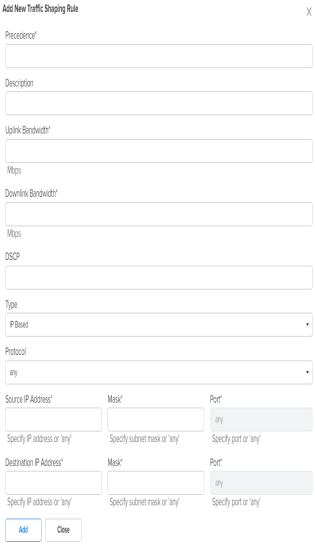

Traffic Shaping
Note: Traffic Shaping supports up to 16 rules per WAN.
To add a new traffic shaping rule, click Add New, the Add New Traffic Shaping Rule window appears, as shown in Figure 24.
Enable Traffic Shaping
Indicates whether traffic shaping is enabled or disabled.
Precedence
The precedence value for the traffic shaping rule.
The precedence value can be between 1 and 150.
Description Displays a user-configured description for the traffic shaping rule.
Uplink Bandwidth
Indicates the uplink bandwidth in Mbps.
Range: 1 to 1000
Downlink Bandwidth
Indicates the downlink bandwidth in Mbps

WAN Speed Test
Enable WAN Speed Test
Enable or disable the WAN speed test.
Figure 21  The Add New Source NAT Rule window
Figure 22  The Edit Monitor Host window
Figure 23  The Add New Monitor Host window
Figure 24  The Add New Traffic Shaping Rule window
Figure 25  The Add New Failover Policy window

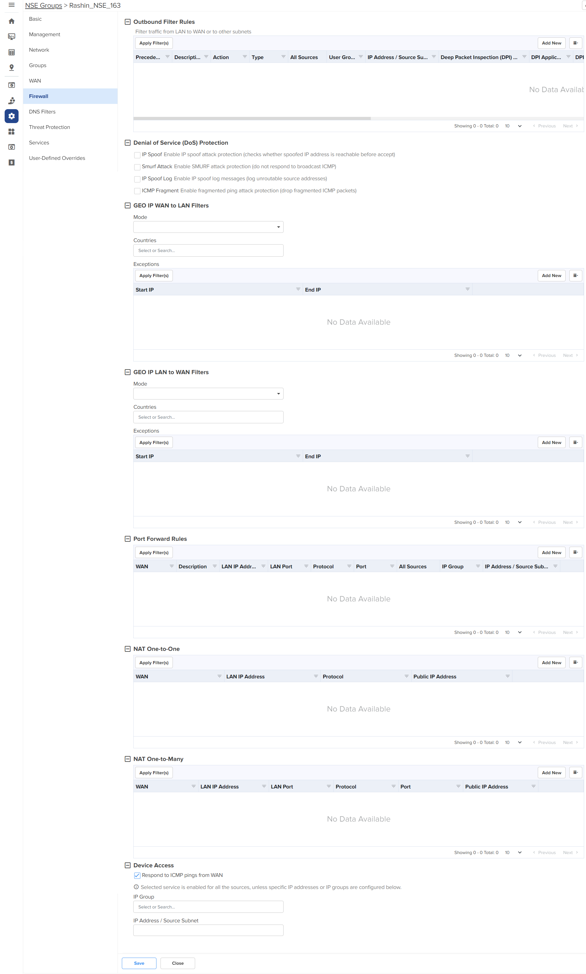

Firewall
NSE 3000 firewall allows the user to configure the IP-based and application-based outbound rules, GEO IP filters, port forward rules, one-to-one NAT mappings, and one-to-many NAT mappings. All inbound connections are denied by default. You can configure port forwarding or NAT rules to allow inbound traffic. Outbound traffic is allowed by default. Using application-based outbound rules, users can create rules to block websites without specifying IP addresses or port ranges. Application-based rules allow the user to block a specific type of application within a category or all applications belonging to a category (For example, social messaging).
NOTE:
Up to 150 outbound firewall rules are supported for an NSE Group including combinations of IP-based and application-based rules.
To configure parameters on the Firewall page, complete the following steps:
1. On the NSE Groups > Add New page, select the Firewall tab.
The Firewall page appears, as shown in Figure 27.
Figure 27  The Firewall page
2. Configure the parameters, as described in Table 8.
Table 8: Parameters on the Firewall page

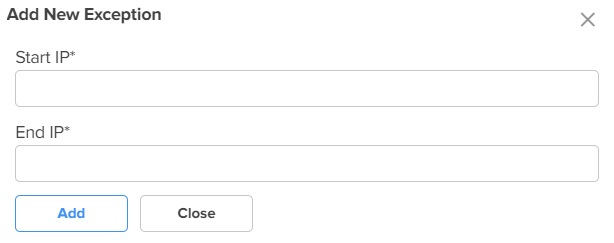

Exceptions
Exceptions allow users to configure source IP address ranges that are allowed in the inbound traffic.
To add a new exception, click Add New. The Add New Exception window appears, as shown in Figure 29.
Start IP
End IP

Exceptions
Exceptions allow users to configure destination IPv4 address ranges that are allowed in the outbound traffic.
Start IP
End IP

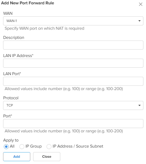

Port Forward Rules
Port Forward Rules allow users to forward traffic destined to the WAN Interface IP address of NSE 3000 on a specific TCP or UDP port to any of the LAN IP address. Port Forward Rules provides remote access to internal resources.
To add a new port forward rule, click Add New. The Add New Port Forward Rule window appears, as shown in Figure 30.
WAN
The interface to forward inbound traffic to the internal host.
  • WAN-1
  • WAN-2
Description
Displays the user-configured description for the port forward rule.
LAN IP Address
The IPv4 address to which traffic will be forwarded.
LAN Port
The LAN port to which the traffic will be forwarded.
Protocol
The protocol of forwarded traffic.
  • TCP
  • UDP
Port
The destination port of the incoming traffic on the WAN interface.
Apply To
  • All
  • IP Group
  • IP Address / Source Subnet
IP Group
This parameter is applicable only when IP Group option is selected.
This parameter is applicable only when IP Address / Source Subnet option is selected.

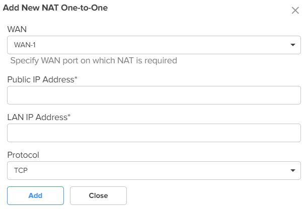

NAT One-to-One
NAT One-to-One allows users to map an IP address on the WAN side to a LAN IP address. The IP address on the WAN side should be different from any of the WAN interface (WAN-1/WAN-2) IP addresses. NAT One-to-One rules provide remote access to any of the LAN resources.
To add a new NAT one-to-one, click Add New. The Add New NAT One-to-One window appears, as shown in Figure 31.
WAN
  • WAN-1
  • WAN-2
Public IP Address
The public IPv4 address on the WAN side that is used to access the LAN resource.
The public IPv4 address is different from the IPv4 address of the WAN (WAN-1/WAN-2) interfaces.
LAN IP Address
The LAN IPv4 address of the server which is hosting the resource.
Protocol
The protocol of the incoming traffic.
  • TCP
  • UDP
NAT One-to-Many
NAT One-to-Many provides remote access to internal resources. It maps a public IP address to multiple LAN IPs and ports.
To add a new NAT one-to-many, click Add New, the Add New NAT One-to-Many window appears, as shown in Figure 32.
WAN
  • WAN-1
  • WAN-2
Public IP Address
LAN IP Address
LAN Port
The LAN Port which is hosting the resource.
Protocol
  • TCP
  • UDP
Port
Device Access
Respond to ICMP pings from WAN
This parameter is disabled by default.
When enabled, this service is enabled for all the sources, unless specific IP addresses or IP groups are configured in the IP Group and IP Address / Source Subnet parameters.
IP Group
Specifies the IP group for this service.
Specifies the IPv4 address or source subnet for this service.
Figure 28  The Add New Filter Rule window
Figure 29  The Add New Exception window
Figure 30  The Add New Port Forward Rule window
Figure 31  The Add New NAT One-to-One window
Figure 32  The Add New NAT One-to-Many window
3. Click Save.

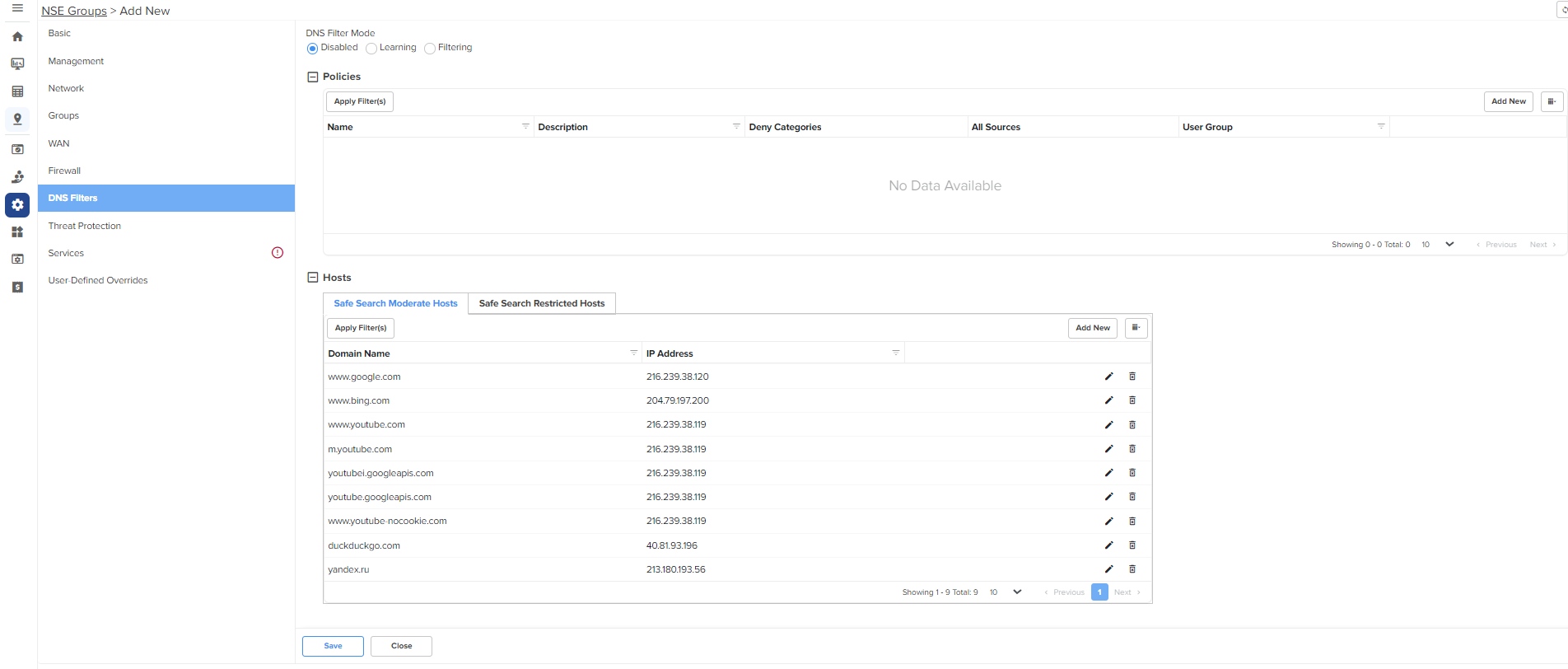

DNS Filters
NSE 3000 supports DNS-based filters. DNS-based filters allow users to block certain category of websites. From the blocked list, users can still allow certain websites by adding them to the exception list. For example, if user blocks social-media category then all the social websites will be blocked including linkedin.com since linkedin.com belongs to social-media category. Adding linkedin.com to the Exception to filters list will allow access to linkedin.com while blocking other social-media websites.
To configure parameters on the DNS Filters page, complete the following steps:
1. On the NSE Groups > Add New page, select the DNS Filters tab.
The DNS Filters page appears, as shown in Figure 33.
Figure 33  The DNS Filters page
2. Configure the parameters, as described in Table 9.
Table 9: Parameters on the DNS Filters page
Parameter
Description
On the DNS Filters page, there are Policies and Hosts sections.
DNS Filter Mode
Specifies the mode for DNS filtering. The following options are supported:
  • Disabled: Disables DNS filter. By default, this option is selected.
  • Learning: Builds local cache for domain categories but does not filter requests.
  • Filtering: Filters requests based on configuration.

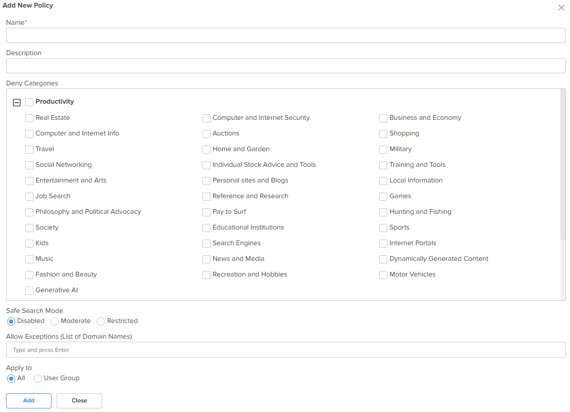

To add a new policy, click Add New. The Add New Policy window appears, as shown in Figure 34.
Name
Name for the policy.
Description
Description about the policy.
Deny categories
Categories to deny in the following sections:
  • Productivity
  • Privacy
  • Sensitive
  • Misc
  • IT Resources
  • Security
Expand the sections and select individual categories. To select all categories in a section, select the check box provided for the section.
Safe Search Mode
  • Disabled: Disables safe search mode. By default, this option is enabled.
  • Moderate: Enable moderate safe search mode.
  • Restricted: Enable restricted safe search mode.
Allow Exceptions (List of Domain Names)
Enter the exempted domain names separated by a comma (,).
Apply to
  • All: Apply to all user groups. By default, this option is selected.
  • User Group: Apply to selected user groups.
User Group
This parameter is applicable only when User Group option is selected for Apply to parameter.

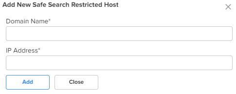

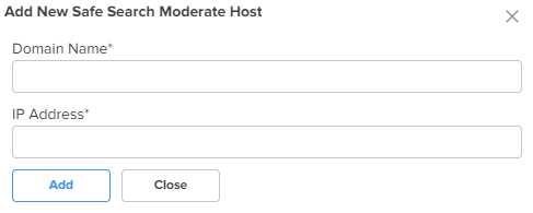

Hosts
Hosts section contains two tabs - Safe Search Moderate Hosts and Safe Search Restricted Hosts
The following parameters appear in both the tabs and can be configured as required.
A list of hosts are already added by default. You can modify these hosts by clicking the edit icon or you can add new hosts by clicking Add New in the respective tabs as shown in Figure 35 and Figure 36.
Domain Name
The domain name for the safe search host
IP address
The IPv4 address of the safe search host.
Figure 34  The Add New Policy window
Figure 35  The Add New Safe Search Moderate Host
Figure 36  The Add New Safe Search Restricted Host

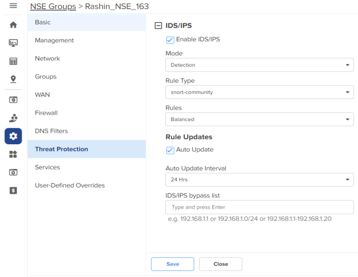

Threat Protection
Using the Threat Protection tab, you can configure the Intrusion Detection and Prevention system (IDS/IPS) parameters.
NSE 3000 supports IDS/IPS engine. IPS engine uses a series of rules that help define a malicious network activity. IPS engine supports rules from snort and emerging threats. The solution supports both community and licensed rules. The IPS engine uses these rules to find packets that match against them and generates alerts for users.
To configure parameters on the Threat Protection page, complete the following steps:
1. On the NSE Groups > Add New page, select the Threat Protection tab.
The Threat Protection page appears, as shown in Figure 37.
Figure 37  The Threat Protection page
2. Configure the parameters, as described in Table 10.
Table 10: Parameters on the Threat Protection page
Parameter
Description
IDS/IPS
Enable IDS/IPS
Indicates whether IDS/IPS is enabled or disabled.
Mode
Specifies the IDS/IPS mode.
  • Detection – Detects malicious activity and generates alerts for users.
  • Prevention – Detects malicious activity, generates alerts for users, and takes action to prevent attacks.
Rule Type
Specifies the IDS/IPS rule type.
  • snort-community – The community rule set is a GPLv2 Talos certified rule set that is distributed free of charge and without any license restrictions. The rules are updated every Tuesday and Thursday.
  • snort-vrt – The Snort Subscriber rule set is developed by Talos research team and is governed by license agreement. The rule set is updated on Tuesday and Thursday. The snort-vrt rule set requires an oinkcode to download and activate rules.
  • emerging-threats open – Consists of signatures contributed from the community. The emerging-threats open rule sets are distributed free of charge.
  • emerging-threats pro – Consists of signatures created as a result of Proofpoint research. The rule sets are governed by license agreement. The emerging-threats pro rule set requires an oinkcode to download and activate the rules.
Rules
Specifies the IDS/IPS rule policy. This parameter is applicable when Rule Type is snort-vrt or snort-community.
  • Connectivity – Policy designed to favor device performance over the security controls in the policy.
  • Balanced – This policy is the default policy that is recommended for initial deployments. The policy attempts to balance security needs and performance characteristics.
  • Security – This policy is designed for customer base that is extremely concerned about organizational security. This policy is deployed in networks that have higher security requirements.
Oink Code
This parameter is applicable when Rule Type is snort-vrt or emergency- threats pro.
Category
Categories to select from the Category section. This parameter is applicable when Rule Type is snort-vrt or emergency- threats pro.
Rule Updates
Auto Update
Indicates whether the IDS/IPS rules must be automatically updated or not.
When Auto Update is enabled, NSE 3000 will periodically download and activate the IDS/IPS rules.
Auto Update Interval
Time interval for the periodic updates of IDS/IPS rules.
  • 12 Hrs – Auto updates the rules every 12 hours.
  • 24 Hrs – Auto updates the rules every 24 hours.
IDS/IPS bypass list
List of allowed IPv4 addresses or range of allowed IPv4 addresses.
IDS/IPS operating in prevention mode blocks traffic from a host on detecting malicious traffic from the host.
When an IPv4 address is part of allowed IP addresses, IDS/IPS will not block traffic from the host even when malicious traffic is detected.
3. Click Save.

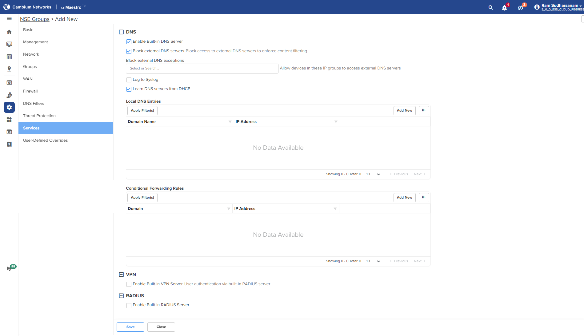

Services
NSE 3000 provides an on-board VPN server that allows remote users to establish a connection using the native VPN client supported in most of the operating systems. The VPN server uses the L2TP/IPsec protocol with the IPsec encryption and hashing algorithms. The VPN server maintains a pool of IP addresses and leases the IP addresses from this pool for remote users.
NSE 3000 also provides an on-board RADIUS server that allows authentication and accounting of enterprise and remote users. The RADIUS server maintains user profiles in a central database.
Using the Services tab, you can configure DNS server, VPN server, and RADIUS server parameters.
To configure parameters on the Services page, complete the following steps:
1. On the NSE Groups > Add New page, select the Services tab.
The Services page appears, as shown in Figure 38.
Figure 38  The Services page
2. Configure the parameters, as described in Table 11.
Table 11: Parameters on the Services page
Parameter
Description
On the Services page, there are DNS, VPN, and RADIUS sections.
DNS
In addition to the below parameters, you can configure parameters in the Local DNS Entries and Conditional Forwarding Rules sections.
Enable Built-in DNS Server
Indicates whether the on-board DNS server is enabled or disabled.
Block external DNS servers
Blocks the client to reach to any external DNS servers.
Block external DNS exceptions Allows the clients added in the exceptions list to reach to any external DNS servers.
Log to Syslog
Specifies whether the DNS queries received from the client is logged to an external syslog server.
Learn DNS servers from DHCP
Dynamically learns the DNS server IP on WAN.
When you disable this parameter, the Primary DNS and Secondary DNS parameters are displayed.
Primary DNS
The IPv4 address of the primary upstream DNS server.
Secondary DNS
The IPv4 address of the secondary upstream DNS server.

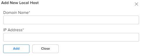

Local DNS Entries
To add a new local host, click Add New. The Add New Local Host window appears, as shown in Figure 39.
Domain
A domain name for the local host.
IP address
The IPv4 address of the local host.

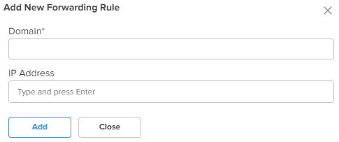

To add a new forwarding rule, click Add New. The Add New Forwarding Rule window appears, as shown in Figure 40.
Domain
A domain name for the forwarding rule.
IP address
The IPv4 address of the server to which the DNS query is forwarded.

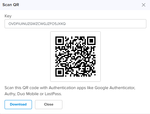

VPN Two-Factor Authentication
  1. When you enable two-factor authentication (2FA), scan the QR code to add a 16-digit key to a particular user's Google Authenticator app.
  2. An email is also sent to the configured email address with the QR code and the 16-digit key.
  3. The two-factor authentication gets enabled for the user when the user tries to connect to the NSE device using the remote VPN client from the WAN side. Users on the LAN side do not require two-factor authentication.

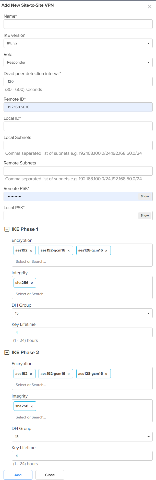

Site-to-Site VPN
IPsec tunnel is a VPN technology that provides a secure, encrypted connection between two devices or networks over the internet or another public network. It uses IPsec protocols to encrypt the traffic between two endpoints, making it difficult for anyone to intercept the communication.
IPsec site-to-site tunnel is used to connect two remote sites for secure communications. NSE allows setting up tunnels both in responder mode as well as initiator mode. Both, IKEv1 and IKEv2 are supported in the configuration. The default version is IKEv2.

To view the IPsec tunnel stats, navigate to the NSE Group > Network > VPN Sites tab, as shown in Figure 42.
To add a new site-to-site VPN, click Add New. The Add New Site-to-Site VPN window appears, as shown in Figure 41.
Name
A name for the new site-to-site VPN.
IKE version
The Internet Key Exchange (IKE) version for the site-to-site VPN. The following options are supported:
  • IKE v1
  • IKE v2
Role
Specifies the role for the tunnels. The following options are supported:
  • Initiator
  • Responder
Default role: Responder
Dead peer detection interval
The interval (in seconds) for detecting dead peers.
Range: 30 - 600 seconds. Default: 120 seconds
Remote ID
The remote ID.
The value of 192.168.50.10 is pre-configured and is not modifiable.
Local ID
The local ID.
Local Subnets
The comma-separated list of local subnets.
Remote Subnets
The comma-separated list of remote subnets.
Remote PSK
The remote PSK.
Local PSK
The local PSK.
The following parameters are common for both IKE Phase 1 and IKE Phase 2.
Encryption
  • aes128
  • aes192
  • aes256
  • aes128-gcm16
  • aes192-gcm16
  • aes256-gcm16
  • 3des
Integrity
The following options are supported:.
  • md5
  • sha1
  • sha256
DH Group
  • 1
  • 2
  • 5
  • 14
  • 15
Key Lifetime
The duration (in hours) for the pre-shared key.
Range: 1 to 24
RADIUS
Enable Built-in RADIUS Server
Indicates whether the built-in RADIUS server is enabled or disabled.
When you enable this parameter, the RADIUS Users and RADIUS Clients sections are displayed.

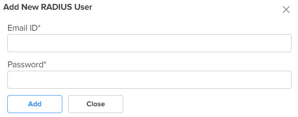

RADIUS Users
To add a new RADIUS user, click Add New. The Add New RADIUS User window appears, as shown in Figure 43.
Email ID
Email ID of the user.
User is either an enterprise user or a remote user.
Password
Password for the user.

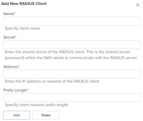

RADIUS Clients
To add a new RADIUS client, click Add New. The Add New RADIUS Client window appears, as shown in Figure 44.
Name
Name of the RADIUS client.
Secret
The shared secret of the RADIUS client. This is the shared secret (password) that the NAS needs to communicate with the RADIUS server.
Address
The IPv4 address or network address of the RADIUS client.
Prefix Length
The client network prefix length.

Figure 40  The Add New Forwarding Rule window
Figure 41  The Add New Site-to-Site VPN window

Figure 43  The Add New RADIUS User window

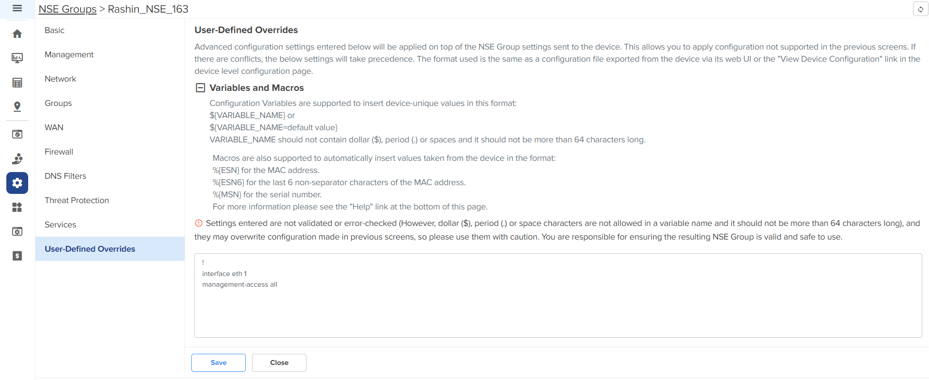

User-Defined Overrides
Using the User-Defined Overrides tab, you can configure the user-defined overrides.
To configure parameters on the User-Defined Overrides page, complete the following steps:
1. On the NSE Groups > Add New page, select the User-Defined Overrides tab.
The User-Defined Overrides page appears, as shown in Figure 45.
Figure 45  The User-Defined Overrides page
2. In the text box, enter the configuration that you want to apply to the device.
3. Click Save.
Configuring WAN in the device UI
In the WAN page, you can configure the device’s IPv4 address based on the IP mode.
NOTE:
If PPPoE is used as the WAN connection mode as shown in Figure 46, make sure to configure the PPPoE username and password. Once you have configured the PPPoE user name and password, you can proceed to configure the NSE group by providing the same username and password and then attaching the default NSE group to the device.
Figure 46  PPPoE as WAN connection mode
To view and configure the WAN settings, complete the following steps in the device UI:
1. From the main NSE 3000 dashboard page, click WAN tab from the left panel.
The WAN page appears, as shown in Figure 47.
NOTE:
By default, WAN-1 page appears. You can configure WAN on WAN-1 or WAN-2.
Figure 47  The WAN page
2. Configure the parameters, as described in Table 12.
Table 12: Parameters on the WAN page
Parameter
Description
IP Mode
Determines the network that must be configured to use IPv4 addresses.
  • Dynamic
  • Static
  • PPPoE
By default, the Dynamic mode is selected.
VLAN ID
The VLAN ID can range from 1 to 4094.
The VLAN configuration is optional.
Following parameters appear only when you select the mode as Static from the IP Mode drop-down list, as shown in Figure 48.
IP Address
The 32-bit binary number that identifies a network element by both network and host.
Subnet Mask
The subnet mask for the destination IP/network for the route.
Gateway
The gateway for the destination IP/network for the route.
DNS
Primary DNS
The IPv4 address of primary upstream DNS server.
Secondary DNS
The IPv4 address of secondary upstream DNS server..
Following parameters appear only when you select the mode parameter as PPPoE from the IP Mode drop-down list, as shown in Figure 49.
Account Name
The name of Access Controller.
Service Name
Service name of Access Controller.
User Name
A user name for PPPoE authentication.
This parameter is mandatory.
Password
A password for PPPoE authentication.
MTU
MTU for PPPoE interface in bytes.
Default: 1492. Range: 500 to 1492
TCP MSS Clamping
Figure 48  Static mode
Figure 49   PPPoE mode
3. Click Save.
