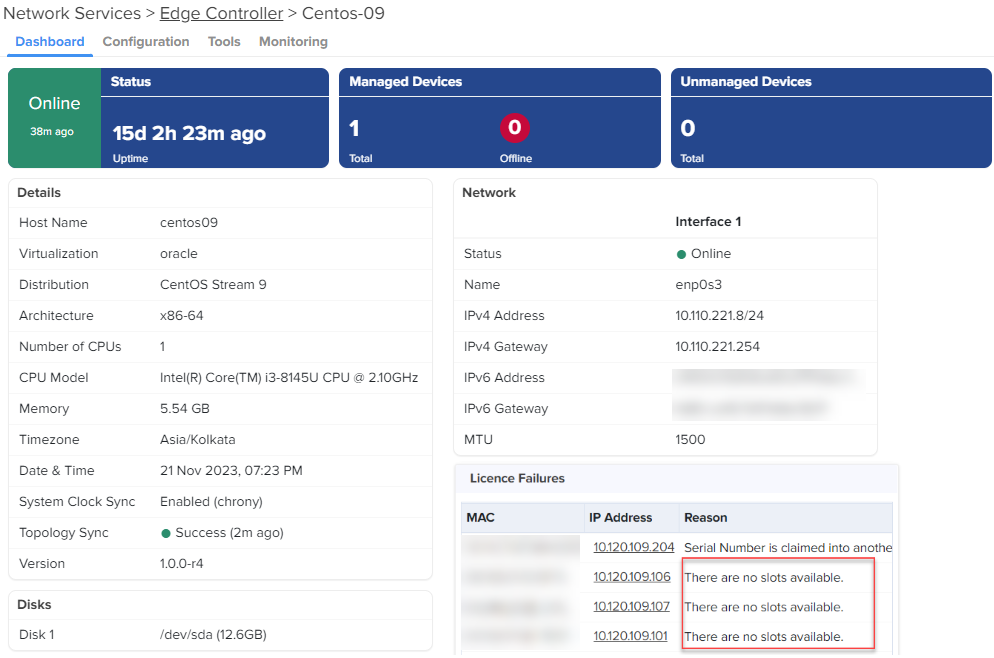

| l | Not Enough Slots available in PTP 820/850 devices |
User receive the license failure message in PTP 820/850 device dashboard, when no slots are available.

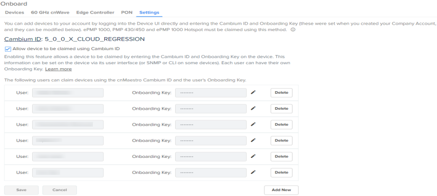

The Cambium ID is defined when the Cloud management is created. You can view it on the page; it uniquely identifies the account.
To claim a device with Cambium ID, you need to have access to the device. Cambium ID claiming is required for devices that do not have a 12-character Serial Number, and it is optional for devices with a 12-character Serial Number. There are two ways to claim a device with Cambium ID.
Type |
Description |
Device UI |
Enter the Cambium ID/Onboarding Key directly into the Device User Interface. This prompts the device to access Cambium Cloud and be placed in the Onboarding Queue. |
Device SNMP |
The Cambium ID/Onboarding Key can also be entered into the device over SNMP. This allows one to quickly onboard existing devices using an SNMP manager. The correct OID will be dependent upon the device type. The string entered into the OID should be of the format “<Cambium ID>:<Onboarding Key>”. |
The directions for each specific device type are presented later in this chapter. Once devices are added to the Onboarding Queue using Cambium ID, the administrator must approve them prior to them being onboarded.
You must configure the Cloud Manager to support Cambium ID onboarding. Once enabled, Cambium ID onboarding will work for all device types.
Figure 2 Cambium ID Configuration
An Onboarding Key must be associated with a Cambium ID before onboarding. This provides security and tracking benefits for onboarded devices. The Onboarding Key can be configured at Onboard > Settings.
Each onboarding key is mapped to an account administrator. This allows Cambium Cloud to know who is onboarding a device. Onboarding Keys can also be revoked if needed.

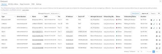

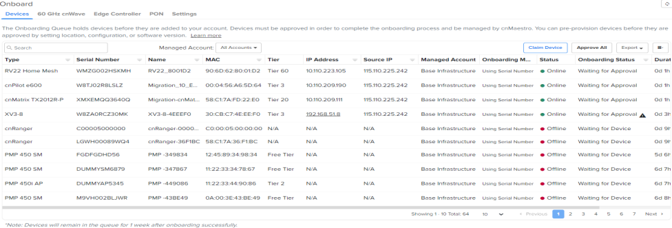

The Onboarding Queue holds a list of pending and recent (last 24 hours) device onboards. It allows the administrator to pre-provision device software and configuration, as well as signal a device is ready to be onboarded. The process flows for how the Onboarding Queue is used are slightly different based upon how the device was claimed.

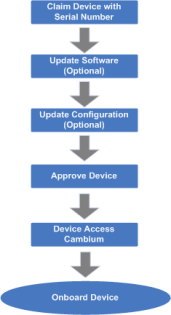

When onboarding with Serial Number, the device can be fully provisioned before it contacts Cambium Cloud and is placed in the Cloud Management. This allows it to be added immediately upon connection.
Figure 3 Serial Number flow
When a user onboards using a Serial Number, the software update and configuration can be defined even before the device physically accesses the account. |

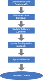

The flow is a little different when using Cambium ID. Here devices must connect to Cambium Cloud before they are added to Cloud Management. The administrator needs to then approve them in the Onboarding Queue after optionally updating the software version and device configuration.
Figure 4 Claiming Devices Using Cambium ID
The following table details the columns in the Onboarding Queue. Some of these fields will be unknown or uncertain until the physical device has contacted Cloud Management.
Parameter |
Description |
Actions |
Before a device is onboarded, it must be approved. There are two buttons available:
Added By |
The user who added this device for onboarding. Note: If the Device is claimed by a tenant user, the user information is not shown on the Onboarding page. |
Configure |
This highlights configuration that is applied to the device before onboarding. It is presented as a set of icons that represent: software update, configuration update, and map placement. The icons have the following colors:
Device |
The name of the device. This is set manually, or, if unset, it will be read from the device. |
Duration |
Displays when the status last changed for the device. |
IP Address |
The IP address of the device. This is only available after the device contacts cnMaestro. |
MAC Address |
The MAC address of the device (if known). |
Serial No |
The Serial Number of the device. |
Status |
The current status of onboarding: The device has contacted cnMaestro, but it has not been approved, so it is in a waiting state. Waiting for Devices: The user has claimed the device, but the device has not connected. Onboarded The device has completed onboarding and must now be managed through normal Configuration and Software Update processes. |
Type |
The type of the device (if known or manually configured). |

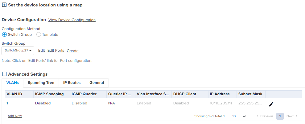

Onboarding configuration can be modified until the onboarding process has begun. The approval however needs to be turned off before any changes can be made. |
The basic configuration includes Serial Number, MAC, Device Name, Mode, and Description. A Comment can also be specified to provide additional context to the device.
Configure Device follows the standard template system (see the section on Template Configuration for full details). The administrator can select an existing configuration template and set any required variables.
The administrator can select configuration method with the existing template or Switch Group.
User can configure the following Switch Group options while onboarding the devices:
| | General |
| | IP Routes |
| | Spanning Tree |
| | VLANs |

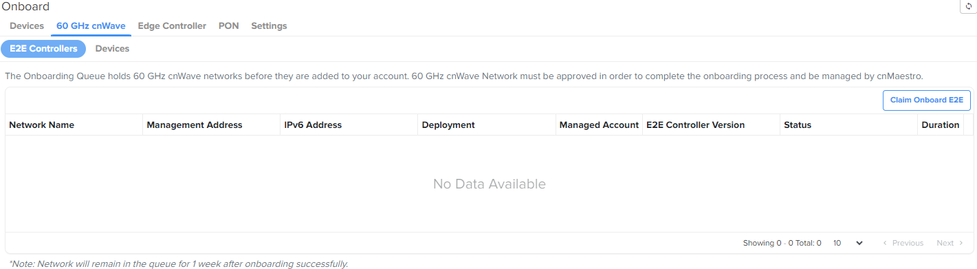

The Onboarding Queue has a separate tab for 60 GHz cnWave E2E Controllers, which must be approved by the user before they are added to cnMaestro as an E2E Network and can manage 60 GHz cnWave devices. This approval can be done either through the Onboarding Queue or the Hierarchical Tree (where the E2E Network is placed).
Once the onboarding is approved, the 60 GHz cnWave E2E Network (and its devices) can be managed by cnMaestro.

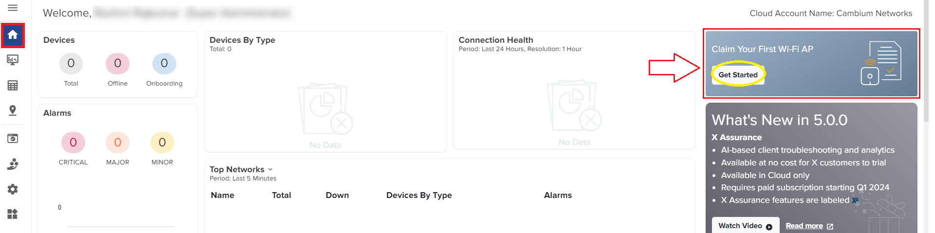

Figure 5 The Claim Your First Wi-Fi AP option
Figure 6 The Claim Your First Wi-Fi AP widget on the Home page
If there are any APs claimed already for the Wi-Fi devices, this Claim Your First Wi-Fi AP option is not available on Home and Monitor and Manage UI pages
To claim your first Wi-Fi AP for a single device, perform the following steps:
| 1. | On the main Home page, locate the widget on the right side of the page and click Get Started (as shown in Figure 6). |

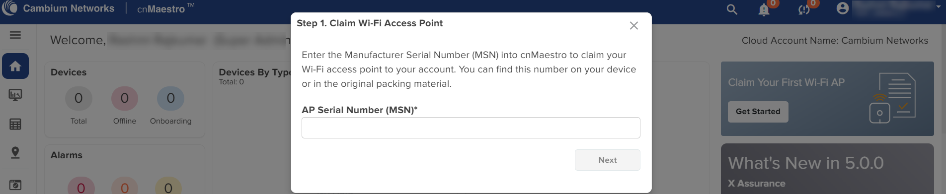

The Claim Wi-Fi Access Point screen appears.

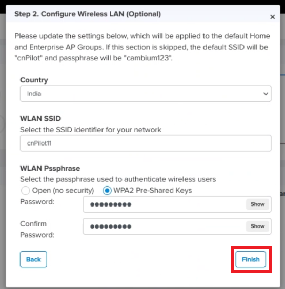

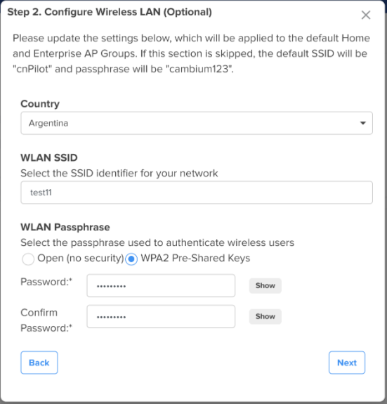

| 2. | Enter a valid value in the AP Serial Number (MSN) text box (for example, AxCx4040Q2V8) and click Next. |
The Configure Wireless LAN (Optional) screen displays multiple settings, which are applicable to Wi-Fi APs (home and enterprise Wi-Fi).
You can update the following settings based on your requirements.
| | Country: Name of the country (used for the regulatory purpose). |
| | WLAN SSID: Unique name or ID that identifies your wireless network. Do not leave this field blank. |
| | WLAN Passphrase: The passphrase is supported only if the WPA2 Pre-Shared Keys option is selected as the security method. The minimum length of the passphrase is eight characters. |
If you skip configuring this settings section, the default SSID and the security configuration of the device are retained.
| 3. | Click Next. |

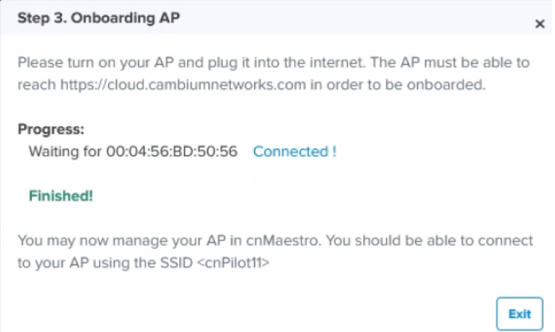

The Onboarding AP screen displays the onboarding status (for example, waiting) for the device. If the device is successfully onboarded, the Onboarding AP screen displays the following message:
If the onboarding fails, the Onboarding AP screen displays a message indicating the failure status.

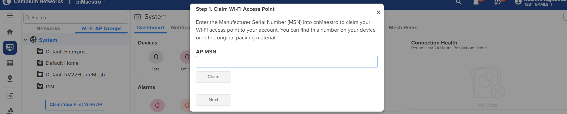

To :
| 1. | Navigate to Monitor and Manage > Wi-Fi AP Groups tree menu, and click (as shown in Figure 5). |
| 2. | Enter a valid value in the AP MSN text box and click Claim. |
The device is successfully claimed.
| 3. | Click Next. |
The Configure Wireless LAN (Optional) screen displays the following fields for configuration: Country, WLAN SSID. and WLAN Passphrase.
| 4. | Enter the configuration details. |
You can configure the following settings based on your requirements:
| 5. | Click Finish. |
The Onboarding AP page displays the onboarding status and configured actions for the device.
The device is mapped to the default Wi-Fi AP Group, and the configuration is updated in the Default Enterprise WLAN.

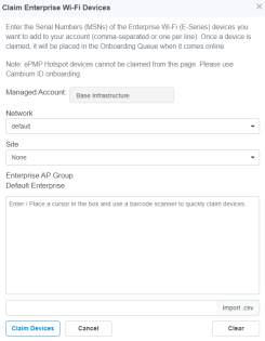

To claim multiple devices from the AP Group, navigate to the Wi-Fi AP Groups tree view and click the
drop-down menu for the selected AP Group.
| 1. | Click the s option. |
| 2. | In the pop-up dialog select the Network and Site under which these devices should be placed and by default devices claimed under this group will have its configuration settings. |
| 3. | Specify the Manufacturing Serial Numbers (MSNs) of the devices line-by-line or comma-separated, or click the Import .csv option to import the MSNs of the devices from a file. |
| 4. | Click to add to the selected AP Group with the configuration applied. |
In cnMaestro On-Premises the procedure is the same as Cloud, but instead of MSN, the user should use the Device MAC Addresses. |
To claim multiple devices from the Site Dashboard, perform the following steps:
| 1. | Navigate to the Manage > Network tree view and select the drop-down menu for the Site. |
| 2. | Click from the drop-down. |
| 3. | In the pop-up dialog select the AP Group that should be applied for Enterprise Wi-Fi devices. The devices claimed under this site will have the configuration settings from the selected AP Group. |
| 4. | Specify the MSNs of the devices line-by-line or comma-separated, or use the option to import the MSNs of the devices from a file. |
| 5. | Click to add the devices to the selected AP Group and click Apply Configuration. |
