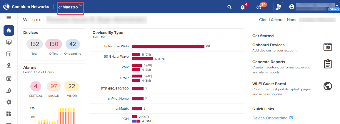

A cnMaestro Essentials account can be identified as shown below.
If a subscription is active, the cnMaestro X banner will display.

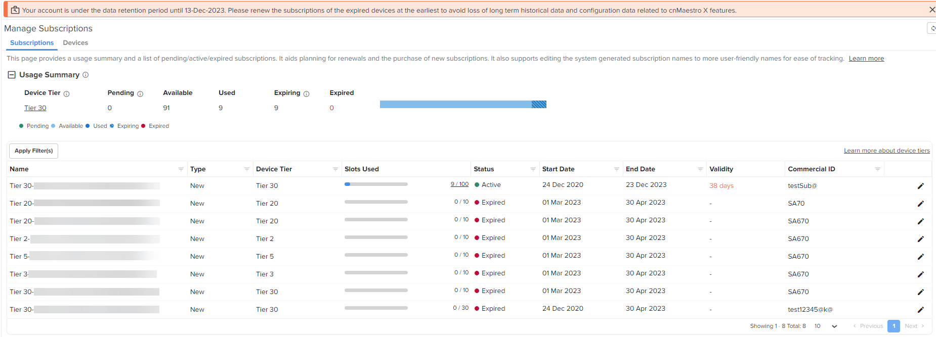

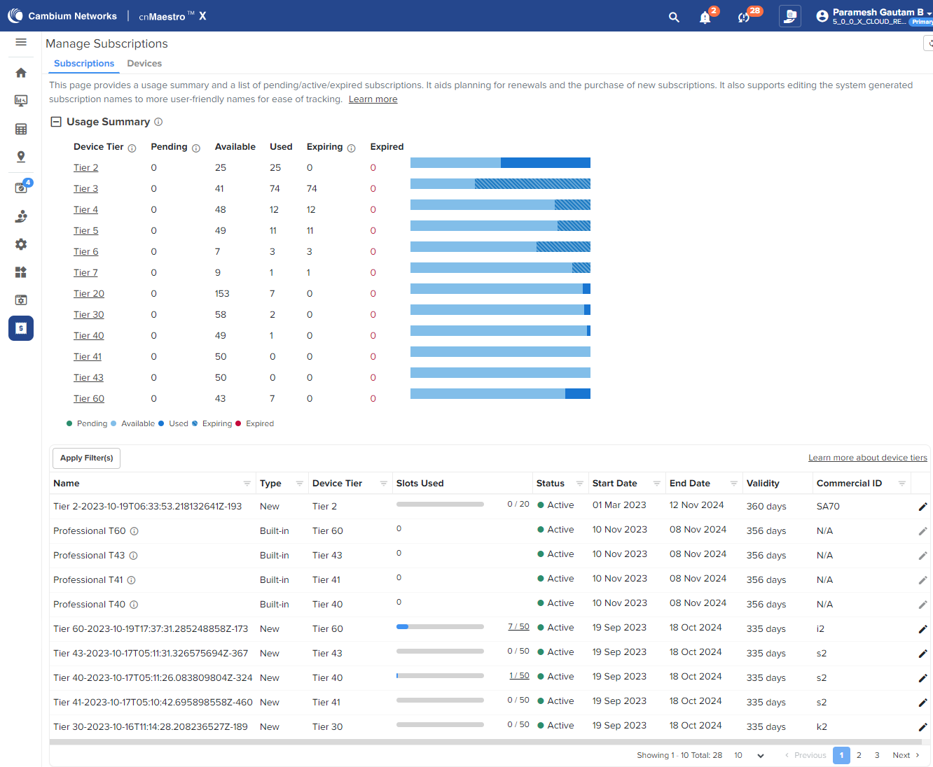

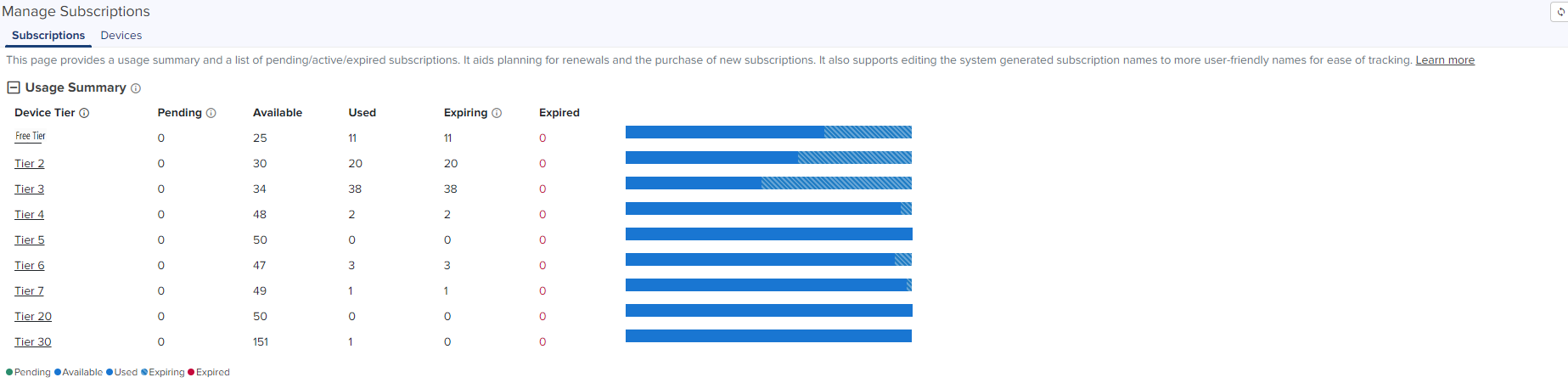

Usage Summary
Usage summary displays the number of slots that are Pending, Available, Used, and Expired.

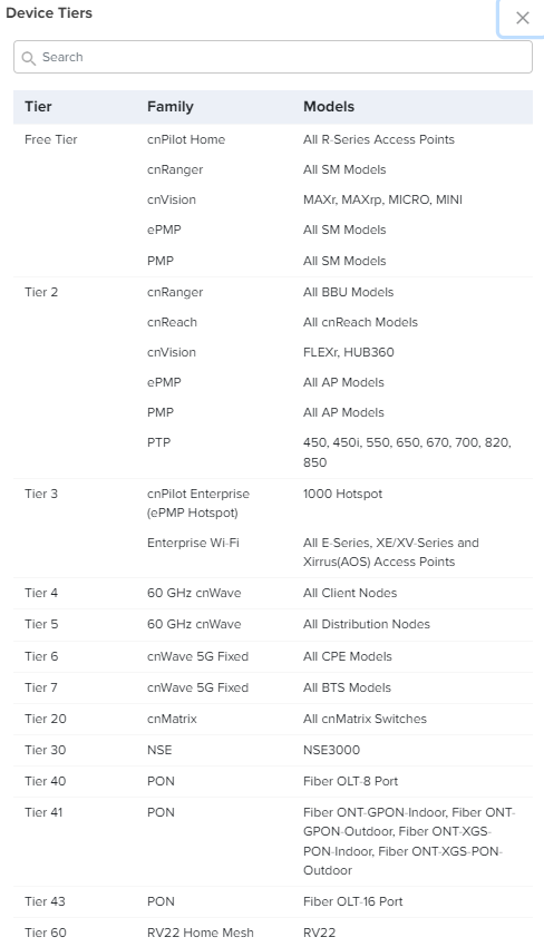

Device Tiers
Device Tiers display the classifications allotted for each device.
Unlisted devices do not require paid subscription. They are part of the Free Tier (Tier 0). All Tier 0 through Tier 7 devices can be used with an Essentials account. Tier 20 and Tier 30 require paid subscription even in Essentials mode.

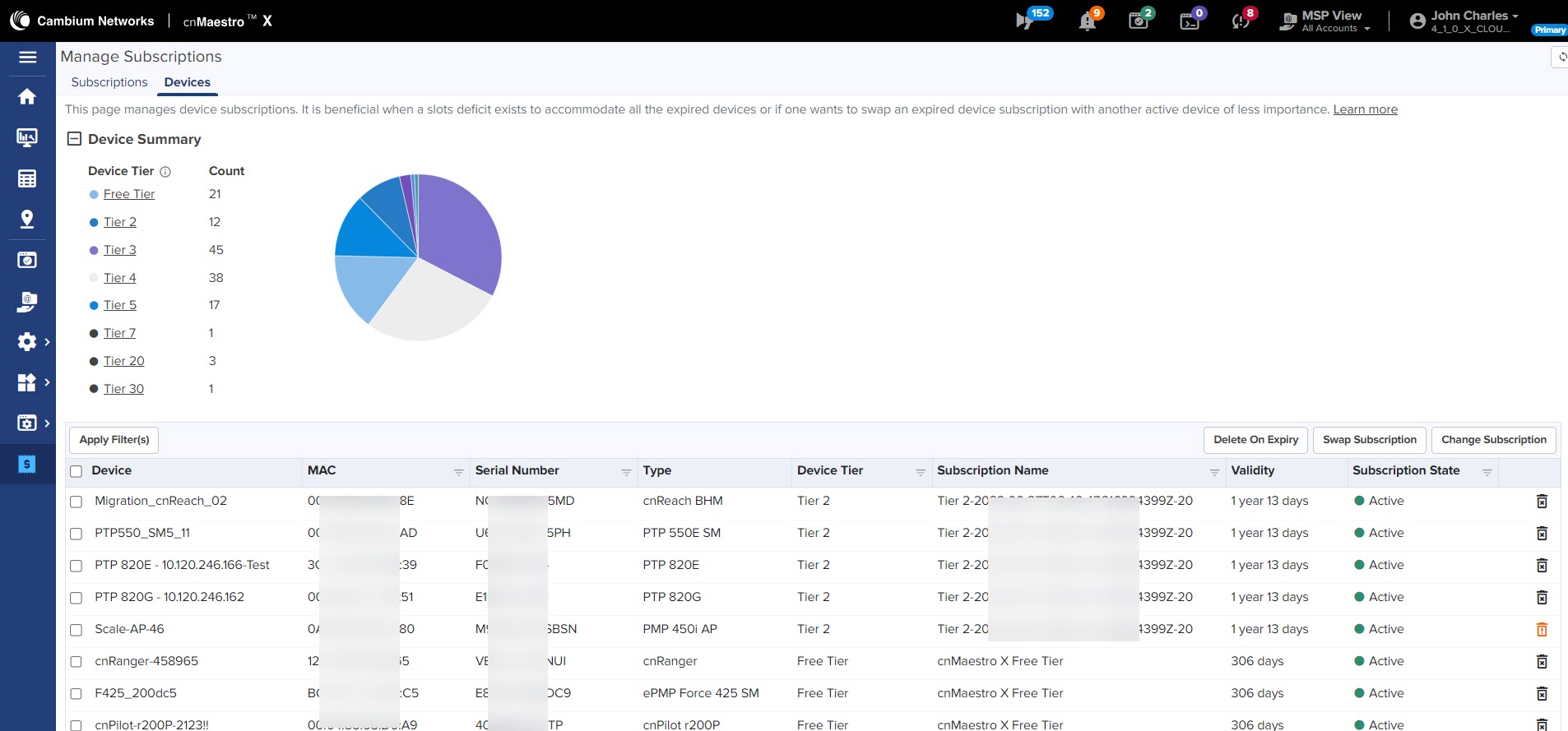

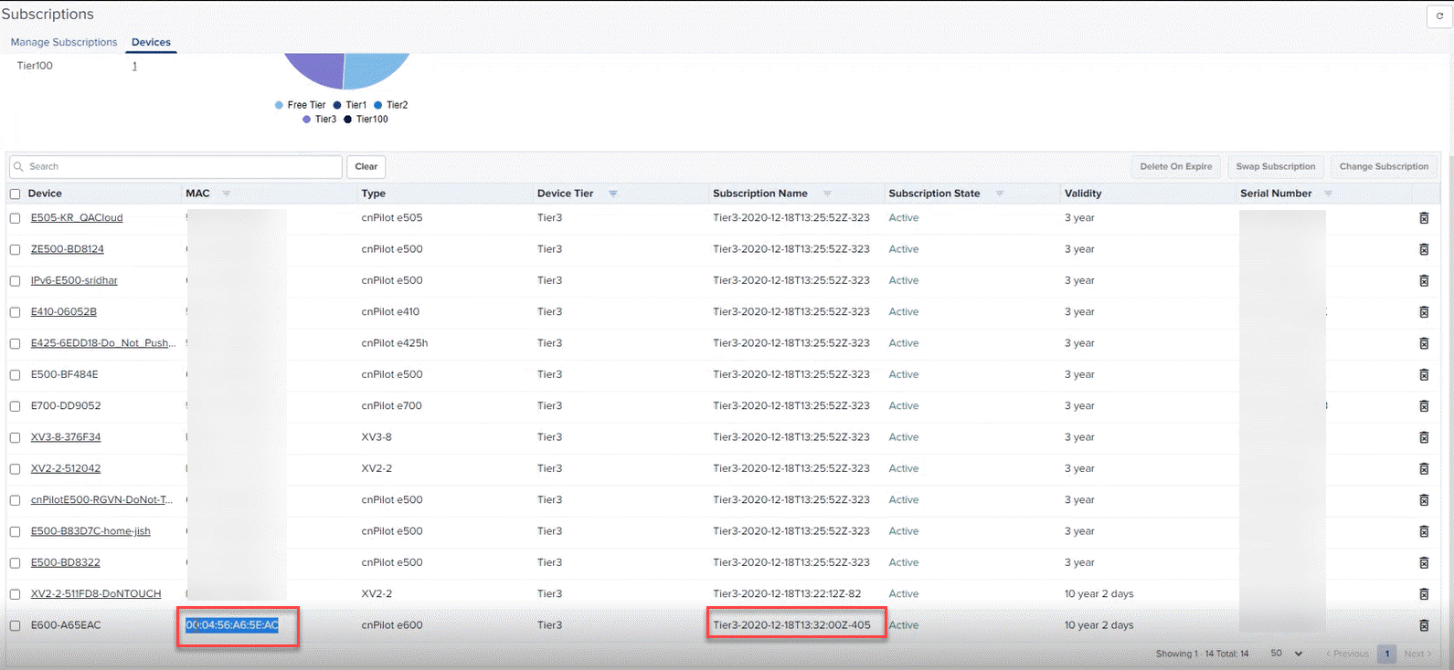

Devices
The Devices page displays devices mapped to their subscription, and it allows changing or swapping a subscription. Device Summary displays device counts per tier.

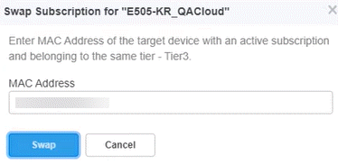

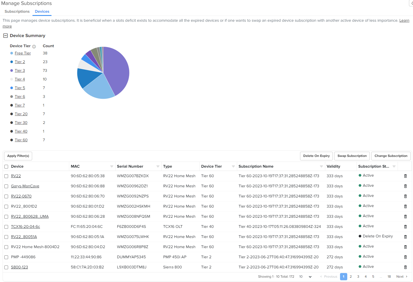

Swap Subscription
Swap Subscription allows the user to swap one device subscription with another device of the same tier. It can be performed at any time.
NOTE:
Swap subscription operation is not allowed for devices belonging to Free Tier, Tier 40, Tier 41, Tier 43, and Tier 60.
To swap subscriptions:
1. Navigate to the Subscriptions > Devices and copy the MAC address to which the device subscription needs to be swapped.
2. Select the device to be swapped to another subscription.
3. Click Swap Subscription. Enter the MAC Address and click Swap.
Device updated successfully message displays on success.

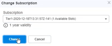

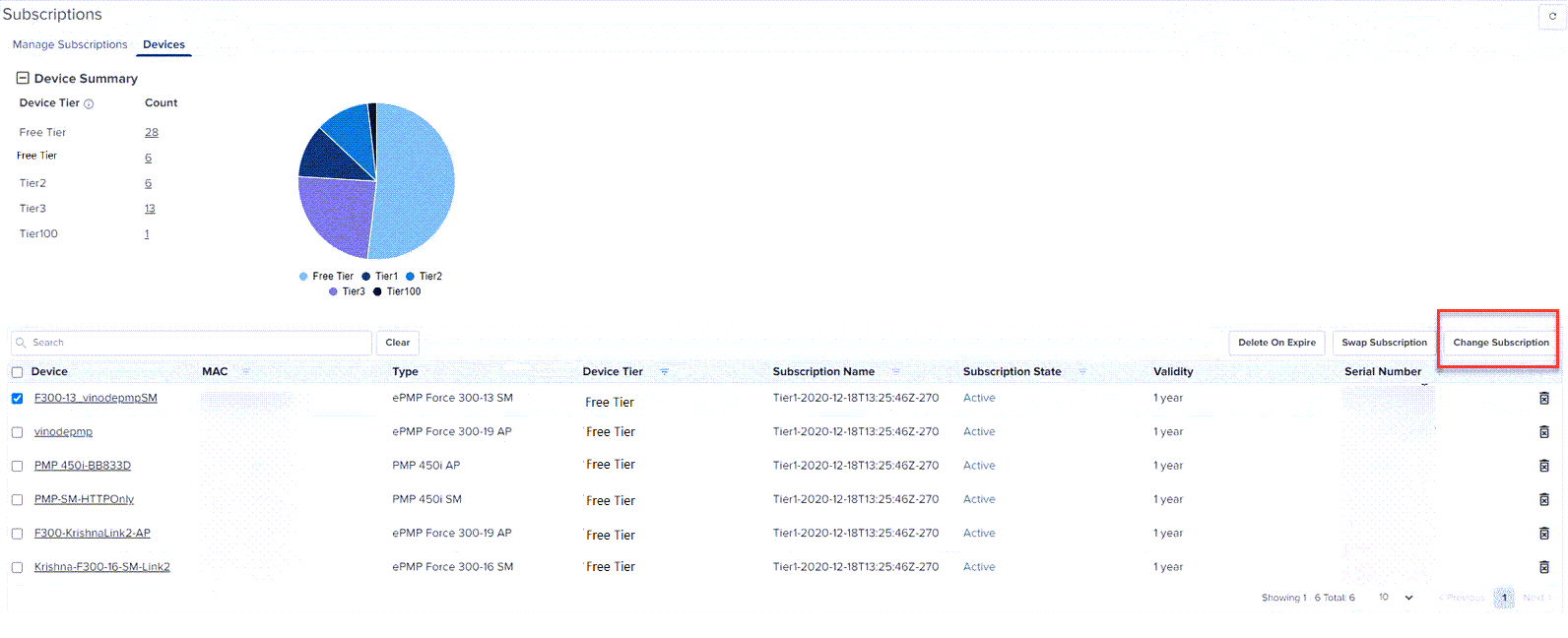

Change Subscription
Change Subscription changes the device from one subscription to another of the same tier when slots are available.
NOTE:
Change subscription operation is not allowed for devices belonging to Free Tier, Tier 40, Tier 41, Tier 43, Tier 60.
To change subscription:
1. Navigate to the Subscriptions > Devices and select the device and click Change Subscriptions.
2. Change Subscription window pops up, select the Subscription from the drop-down.
3. Click Change. Success notification pops up.

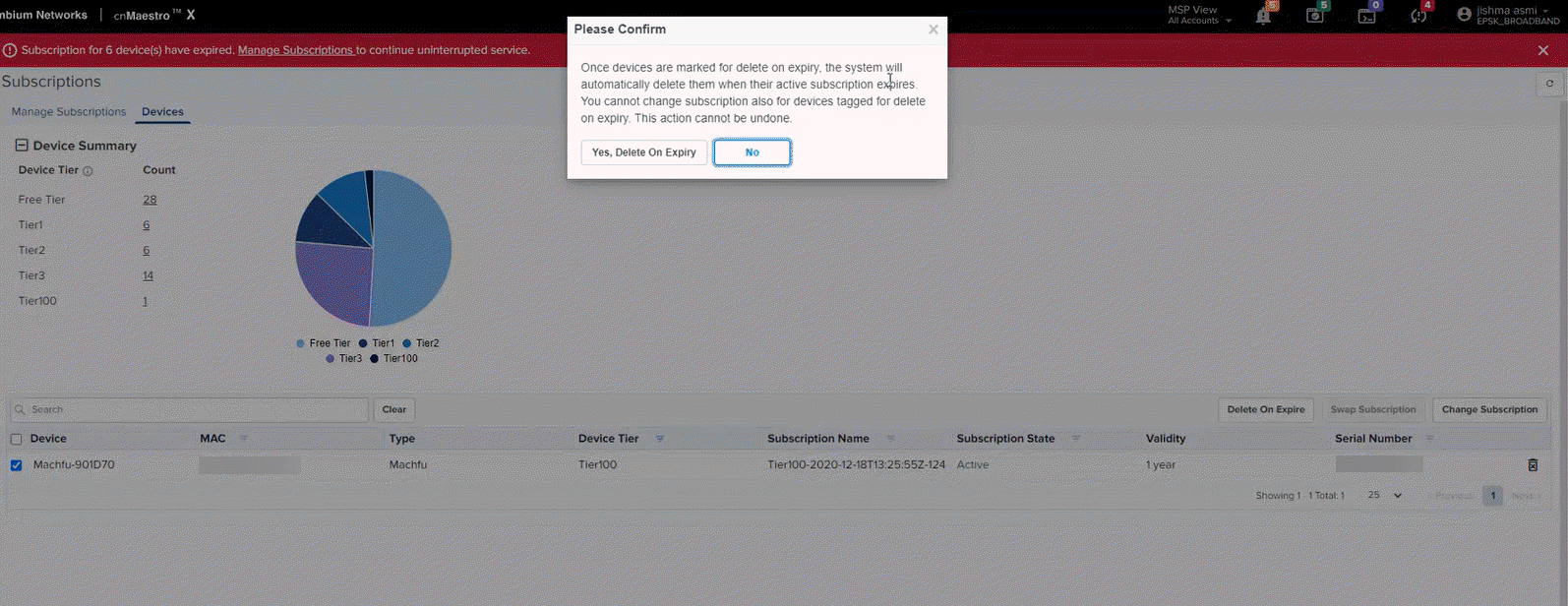

Delete on Expiry
Note:
  • Once a device state is changed to Delete on Expiry, this action cannot be undone.
  • Tier 30 (NSE) devices also support Delete on Expiry in cnMaestro Essentials.
User can select the device and set the subscription state to Delete on Expiry, once the device is expired, it automatically is deleted from the device list.
To set the Delete on Expiry:
1. Navigate to the Subscriptions > Devices and select the device.
2. Click Delete on Expiry.
3. Please Confirm window pops up.
4. Click Yes Delete On Expiry.
5. Subscription state changes to Delete on Expiry from Active.

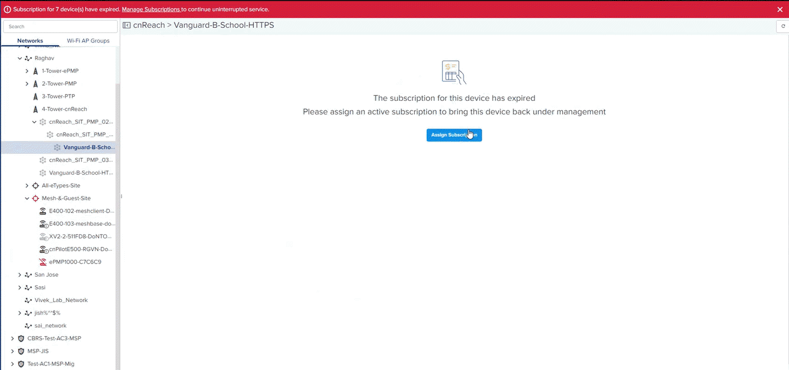

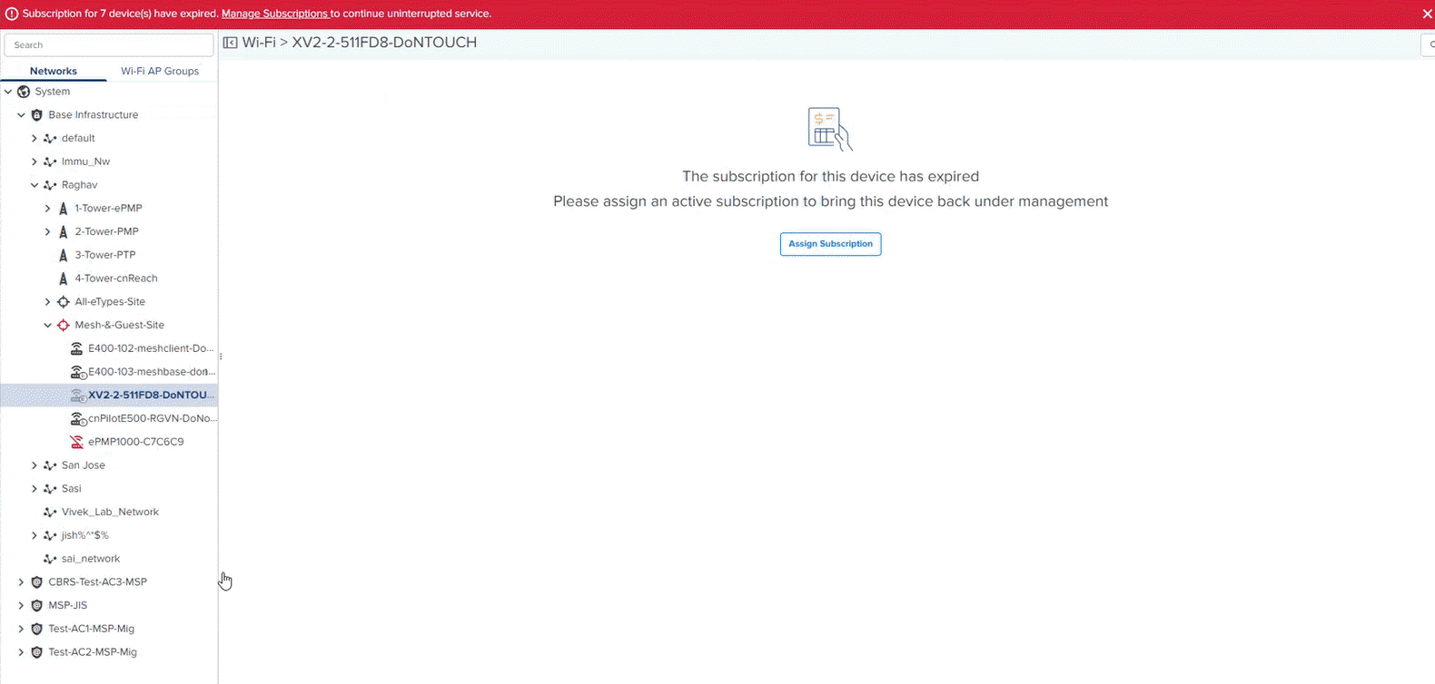

Expired Device
Once the device expires, all device level features become inaccessible. The device should either be deleted from the account or added to a new subscription as shown below:
Note:
In the expired device dashboard:
If any free slots are available Change Subscription will be enabled.
If free slots are not available Swap Subscription will be enabled with the specific device MAC address.
If you have an X account with expired devices, you can downgrade to Essentials and manage all devices without X features. The activated subscriptions will be moved to pending state.

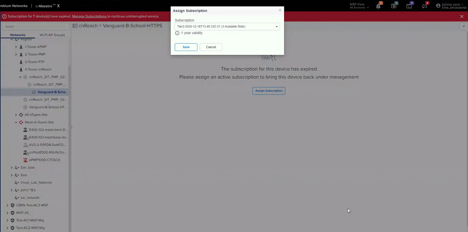

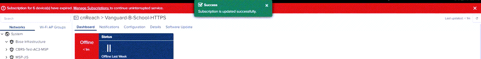

Change Subscription at device level
1. Navigate to Manage > Network > and select the expired device.
2. Click Assign Subscription and select the Subscription from the list.
3. Click Save.
The following message displays if successful and the device becomes active.

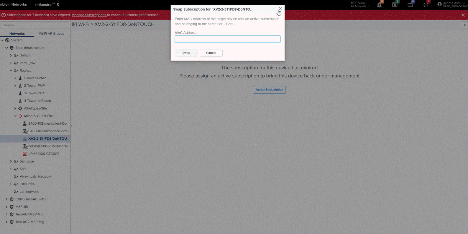

Swap Subscription at device level
2. Click Assign Subscription. The Swap Subscription window pops up.
3. Enter the MAC address and click Swap.
Retention of Data After Expiry and Reinstatement of Service
