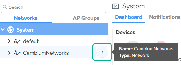

  2. In the Networks tab, search for the network and hover over the network name.
  3. Click the actions () icon and select Add Site.

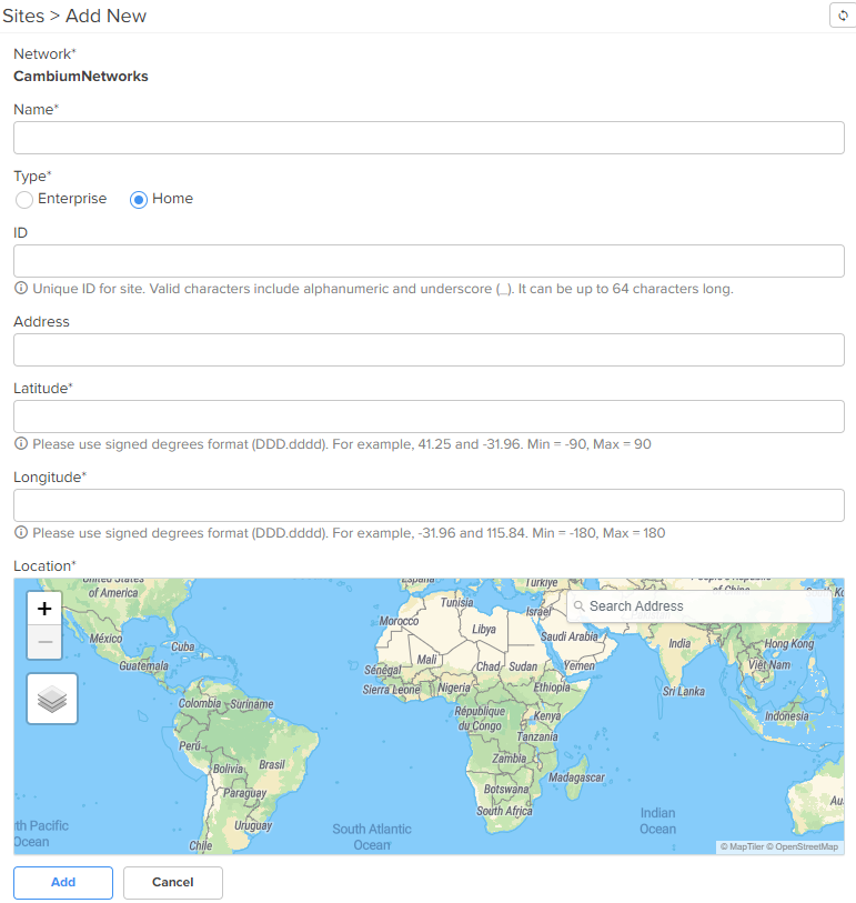

    The Sites > Add New page appears.
  4. Select the Home option in the Type field.
  5. Enter the location details in the Longitude and Latitude fields.
    You can also search for the location in the map to fill in the details.
  6. Click Add.
