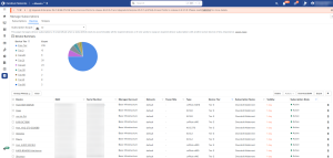

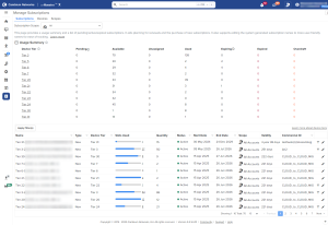

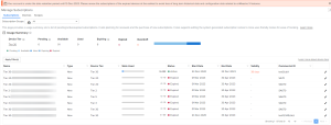

Manage Subscriptions
Users can view, edit, check the validity and status of subscriptions.
  1. Navigate to the cnMaestro > Manage Subscriptions > Subscriptions page.
  2. Click the Edit icon to edit the subscription Name and Description and click Save.

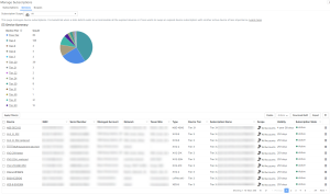

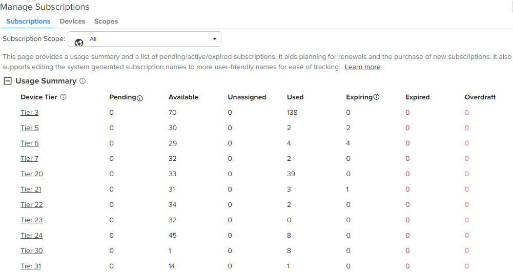

Usage Summary
Usage summary displays the number of slots that are Pending, Available, Used, Expiring, Expired, and Overdraft.

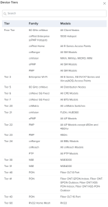

Device Tiers
Device Tiers display the classifications allotted for each device.
Unlisted devices do not require paid subscription. They are part of the Free Tier (Tier 0). All Tier 0 through Tier 7 devices can be used with an Essentials account. Tier 20 and Tier 30 licenses require paid subscription even in Essentials mode.

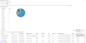

To swap subscriptions:
  1. Navigate to the Manage Subscriptions > Devices and copy the MAC address to which the device subscription needs to be swapped.
  2. Select the device to be swapped to another subscription.
  3. From the Actions dropdown list, click Swap Subscription.
    Enter the MAC Address and click Swap.
    A success notification is displayed on successful subscription swapping.

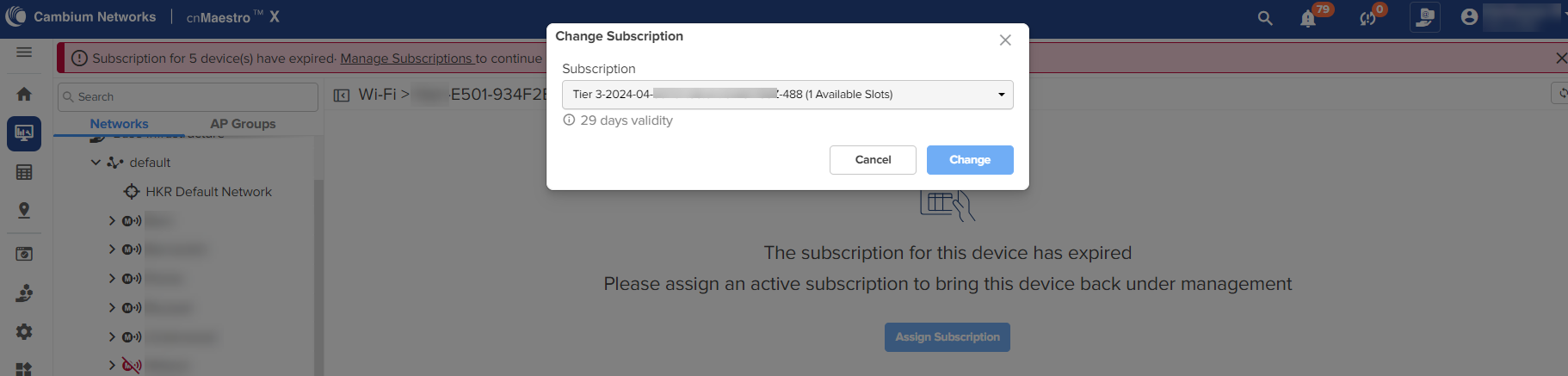

Change Subscription
Change Subscription changes the device from one subscription to another of the same tier when slots are available.
Note
Change subscription operation is not allowed for devices belonging to Free Tier, Tier 40, Tier 41, Tier 43, Tier 60.
To change subscription:
  1. Navigate to the Manage Subscriptions > Devices and select the device.
  2. From the Actions dropdown list, click Change Subscriptions.
  3. Change Subscription window pops up, select the Subscription from the dropdown.
  4. Click Change.
    A success notification is displayed on successful subscription change.

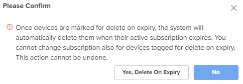

Delete on Expiry
Note
  • Once a device state is changed to Delete on Expiry, this action cannot be undone.
  • Tier 30 (NSE) devices also support Delete on Expiry in cnMaestro Essentials.
User can select the device and set the subscription state to Delete on Expiry, once the device is expired, it automatically is deleted from the device list.
To set the delete on expiry option:
  2. From the Actions dropdown list, click Delete on Expiry.
  3. Click Yes, Delete On Expiry in the confirmation window.
  4. The subscription state changes to Delete on Expiry from Active.

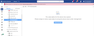

Expired Device
Once the device expires, all device level features become inaccessible. The device should either be deleted from the account or added to a new subscription as shown below:
Note
In the expired device dashboard:
  • If any free slots are available Change Subscription will be enabled.
  • If free slots are not available Swap Subscription will be enabled with the specific device MAC address.

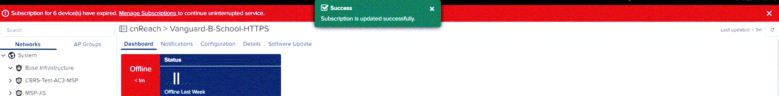

Change Subscription at device level
  1. Navigate to Manage > Network > and select the expired device.
  2. Click Assign Subscription and select the Subscription from the list.
  3. Click Save.
    The following message displays if successful and the device becomes active.

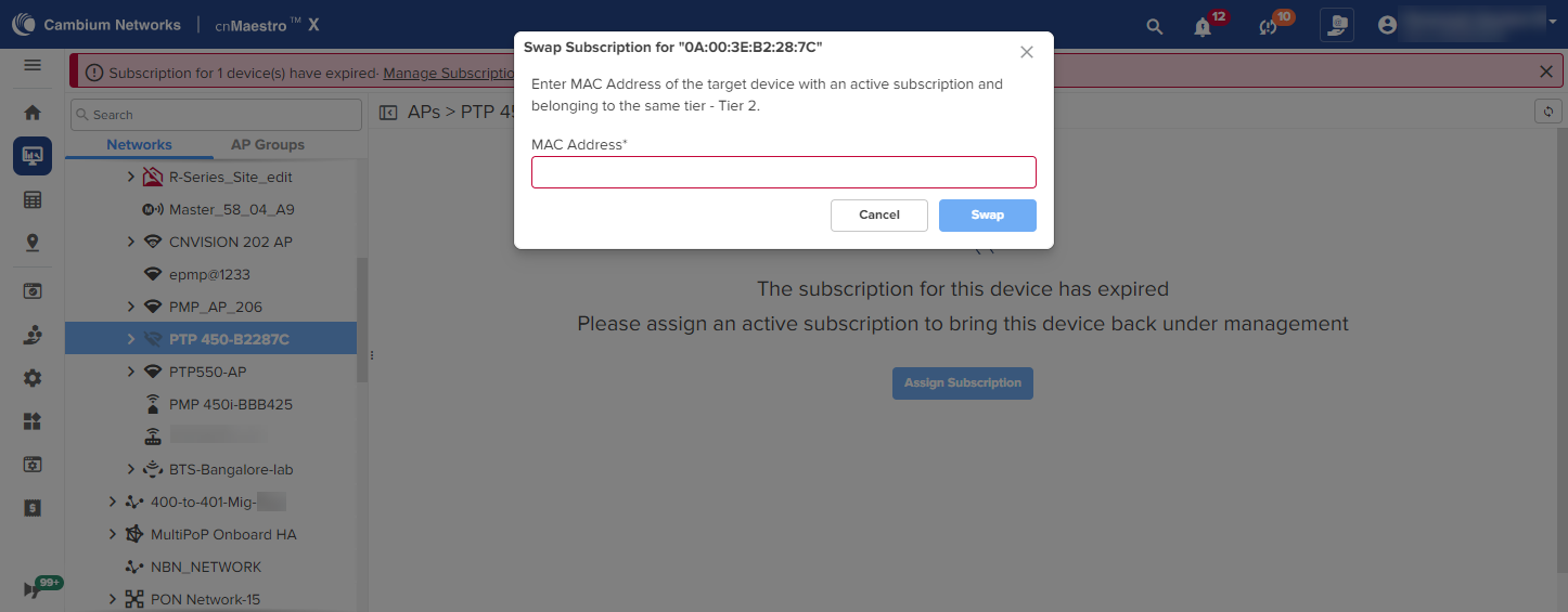

Swap Subscription at device level
  2. Click Assign Subscription. The Swap Subscription window pops up.
  3. Enter the MAC address and click Swap.

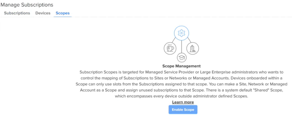

Creating Scopes for Subscriptions
Subscription scopes introduces hierarchical control over subscription allocation, replacing the previous flat structure. It ensures that subscriptions are utilized only within defined scopes, preventing cross-hierarchy usage, and providing better control of subscriptions.
Initially all subscriptions will be part of the shared pool. After scoping is enabled, subscriptions can be assigned to specific hierarchy levels. Scopes can be created at the Managed Account-, Network-, and Site-levels. Devices that are onboarded within a scope can only use the subscriptions allocated to that scope. When a scope is enabled at a particular level, for example, Network, then no other scopes can be enabled for the sites that are present under this network or the Managed Account it is part of.
When subscriptions are shared across scopes, subscriptions are automatically split based on devices present in that scope. However, new subscriptions remain unassigned until they are linked to a scope.
On the Manage Subscriptions page, a new scope filter is available to view the subscriptions assigned to that scope and the devices that are onboarded to those scopes.

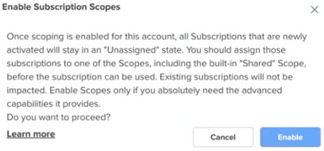

Enabling and adding scopes
To enable and add scopes for subscriptions, complete the following steps:
  1. Navigate to the Manage Subscriptions > Scopes tab.
    The Scopes page is displayed
  2. If scoping is not enabled, click Enable Scope.
  3. Click Enable in the confirmation window that appears.
  4. To add a new scope, click Add Scope.
    The Add Scope window is displayed.

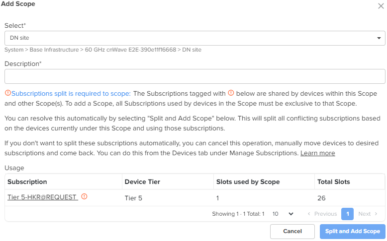

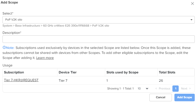

  6. The following options appear:
    1. If no subscriptions are shared by devices in other scopes, then the following information is displayed.
      Click Add Scope.
    2. If subscriptions are shared across devices in other scopes, then a conflict arises.
      This conflict must be resolved by splitting the subscriptions between the scopes.
      You can resolve this conflict in one of the following ways:
      • Automatically, by selecting Split and Add Scope.
        This will split the subscriptions based on the number of devices present in the scope.
      • Manually, by individually moving the devices to the required subscriptions and repeating the steps mentioned in this section.

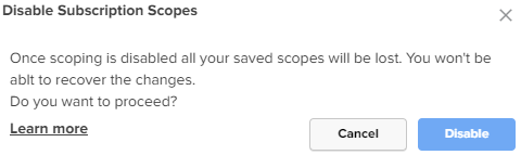

  3. To disable subscription scoping, click Disable Subscription Scopes and click Disable in the confirmation window that is displayed.

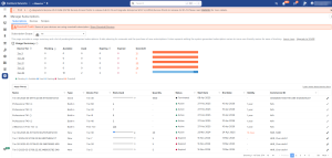

When a device is moved to overdraft, a banner is displayed on the Subscription Summary page as shown in the below figure. In the overdraft credit banner, click Show Overdraft Devices to view the list of devices in overdraft.
On the Devices page displays the Overdraft Devices as shown in the below figure.

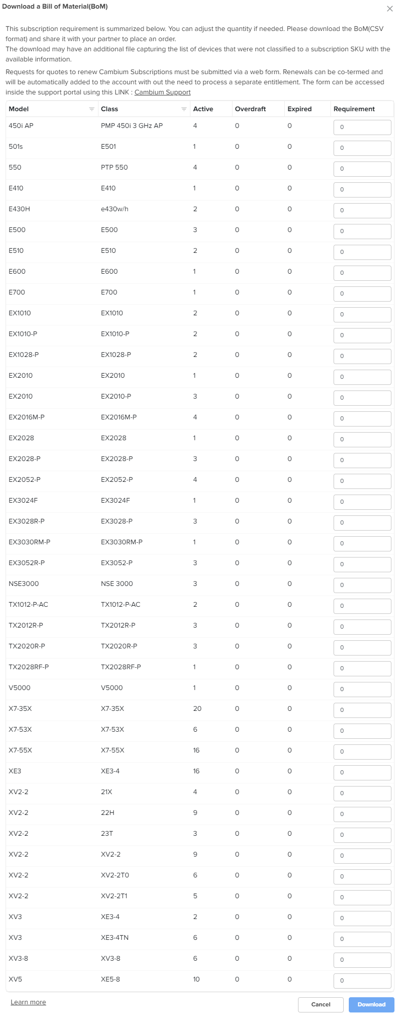

Download a Bill of Material (BoM)
In the Manage Subscriptions > Devices page, the download BoM feature allows the users to generate a summary of the required subscriptions for an account to upgrade. The downloaded file is used to analyze and determine subscription requirements.
Perform the following steps to download the BoM:
  1. Navigate to Manage Subscriptions > Devices.
  2. Click Download BoM.
    Download a Bill of Material (BoM) window appears, as shown in the figure below.
  3. The subscription requirements are generated based on the device model and class.
  4. Modify the subscription count, if required.
  5. Click Download to download the BoM files in the ZIP format.
    Success window pops up.
    The ZIP file contains the BoM files in the CSV format.
Once the BoM file is downloaded, share it with the Cambium Networks support team for validation and to proceed with the required subscriptions.
